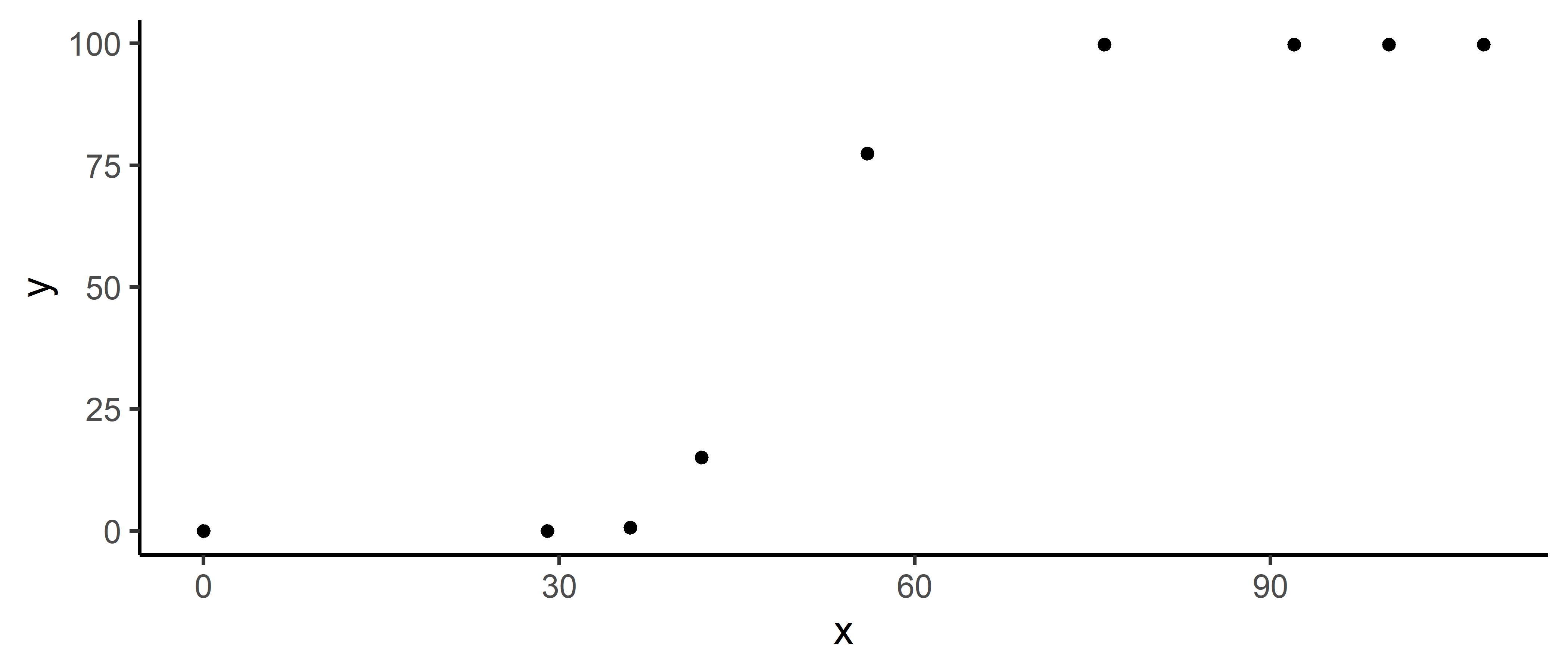

library(flexFitR)
dt <- data.frame(
time = c(0, 29, 36, 42, 56, 76, 92, 100, 108),
variable = c(0, 0, 0.67, 15.11, 77.38, 99.81, 99.81, 99.81, 99.81)
plot(explorer(dt, time, variable), type = "xy")
