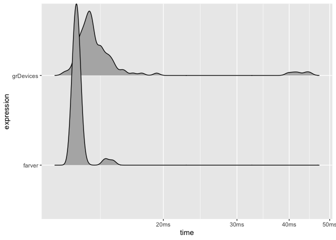

farver is faster than its grDevices counterpart but less so than it was at its first release, as the colour conversion in grDevices has been improved since.
library(ggplot2)
test <- matrix(runif(300000, min = 0, max = 255), ncol = 3)
timing <- bench::mark(
farver = convert_colour(test, 'rgb', 'lab'),
grDevices = convertColor(test, 'sRGB', 'Lab', scale.in = 255),
check = FALSE,
min_iterations = 100
#> Warning: Some expressions had a GC in every iteration; so filtering is disabled.
plot(timing, type = 'ridge')

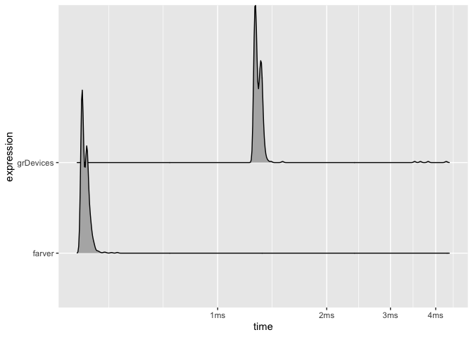

Still, if the start- and/or endpoint are colour strings the ability to decode and encode directly from/to any colour space will give a huge speed up.
colour_strings <- colours()
farver = decode_colour(colour_strings, to = 'lab'),
grDevices = convertColor(t(col2rgb(colour_strings)), 'sRGB', 'Lab', scale.in = 255),
check = FALSE,
