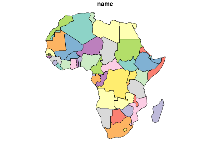

sf_obj <- countries |> filter(continent == "Africa") |> to_sf()
plot(sf_obj["name"])
