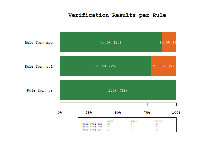

#> 3: Rule for: vs vs %in% c(0, 1) TRUE FALSE 32 32 0 0.0004439354 secsAs we can see, our dataset mtcars does not conform to all of our rules. We have four fails (fail=rule is not met) for the first rule mpg > 10 & mpg < 30 (there are mpg values up to 33.9) and seven fails for the second rule cyl %in% c(4, 8) (there are cyl values of 6), while the third rule vs %in% c(0, 1) is always met.
To see which values do not meet our expectations, use the filter_fails() function
filter_fails(res, mtcars, per_rule = TRUE)

#> 7: 19.7 6 145.0 175 3.62 2.770 15.50 0 1 5 6We can also visualize the results using the plot_res() function.

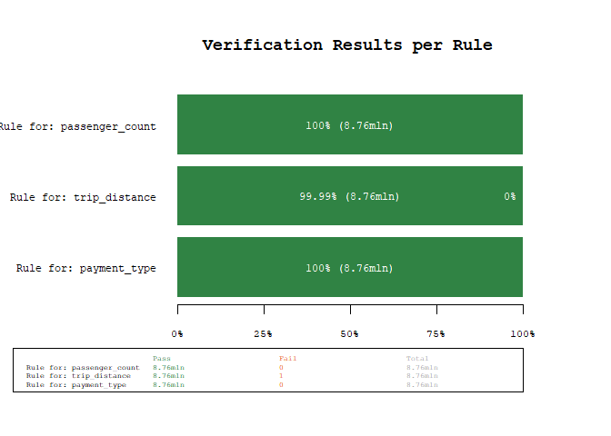

plot_res(res)
Using the power of arrow, we were able to scan 8+mln observations for three rules in about 1.5 seconds (YMMV). As we can see from the results, there is one unexpected value, lets quickly investigate using the filter_fails() function, which filters a dataset for the failed rule matches
