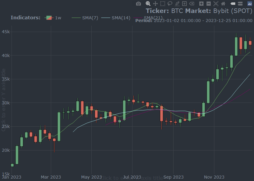

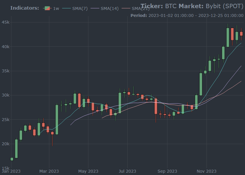

suggestion. See Discussion).chart()-function now has a new option
static that is equal to FALSE by default. If
FALSE the chart can be edited, annotated and explored
interactively.chart()-function now has a new option
palette that is set to “hawaii” by default. See
hcl.pals() for accepted values.chart()-function now has a new option
scale that is set to 1 by default. Scales all fonts on the
chart.chart()-function now has a new option
width that is set to 0.9 by default. Sets the overall
linewidth of the chart. (Thank you @andreltr for the suggestion. See Discussion)# static = FALSE
chart(
ticker = BTC,
main = kline(),
indicator = line(
sma(n = 7),
sma(n = 14),
sma(n = 21)
options = list(
static = FALSE,
palette = "hawaii"
# static = TRUE
chart(
ticker = BTC,
main = kline(),
indicator = line(
sma(n = 7),
sma(n = 14),
sma(n = 21)
options = list(
static = TRUE,
palette = "Set 3"

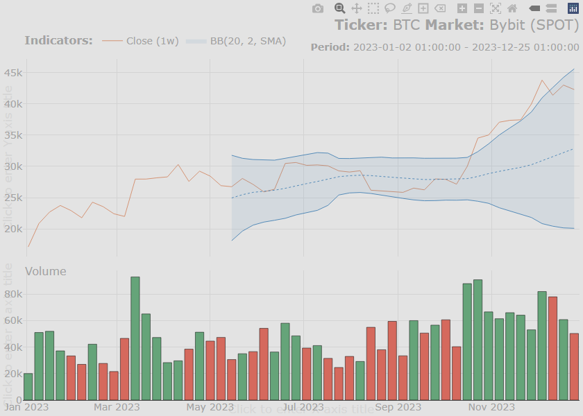

example.pline()
which is a univariate price chart based on either open, high, low or
close prices.chart(
ticker = BTC,
main = pline(price = "close"),
indicator = list(
bollinger_bands(
color = "steelblue"
sub = list(
volume()
options = list(
dark = FALSE

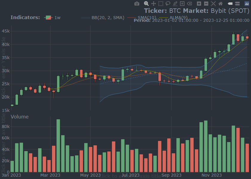

example below,## charting the klines
## with indicators as
## subcharts
chart(
ticker = BTC,
main = kline(),
sub = list(
volume()
indicator = list(
bollinger_bands(),
sma(),
alma()
options = list(
dark = TRUE,
deficiency = FALSE
The following exchanges have been added to list of
