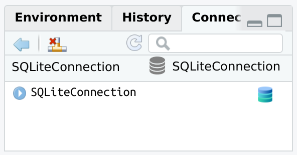

The two main functions added by connections are:

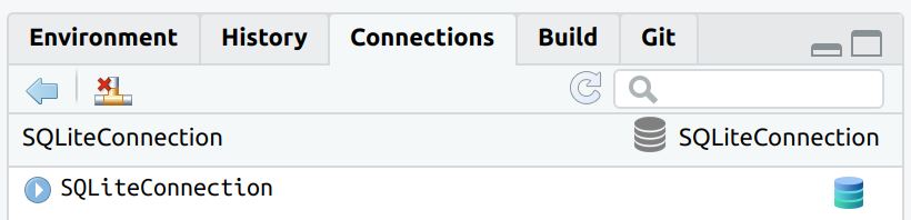

connection_open() - Opens the database connection. Use instead of dbConnect(), but use the exact same arguments. It also automatically starts the Connections pane.connection_close() - Closes the database connection.
The connection can now be closed by using the appropriate button in the Connections pane, or by using connection_close()

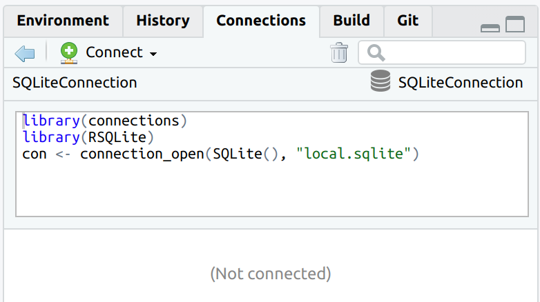

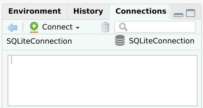

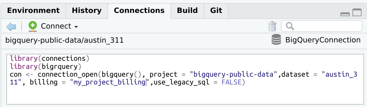

The connection code is parsed when connecting to the database, and it is visible once the connection is closed.

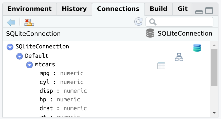

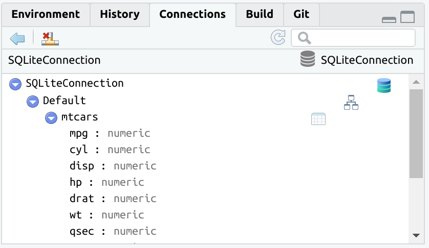

tbl() - To create a pointer to a table or view within the database.copy_to() - To copy data from the R session to the database.The version of copy_to() inside connections automatically updates the Connections pane, so the new table automatically shows up.
con <- connection_open(SQLite(), "local.sqlite")
copy_to(con, mtcars, temporary = FALSE, overwrite = TRUE)

#> # ℹ more rowsTo use an existing table inside the database use tbl().
The tbl() function opens the rest of the already available dplyr database integration.

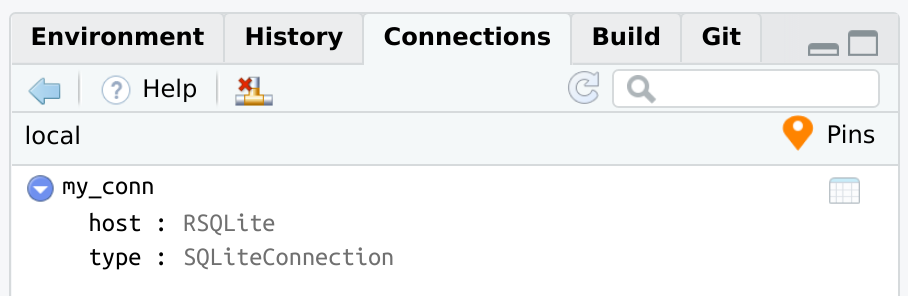

connection_pin_write()connection_pin_read()The connection_pin_write() function does not save the R object. It records the code necessary to recreate the connection.
library(pins)
board <- board_folder("~/pins")
connection_pin_write(board, con, name = "my_conn")

If you wish to see the code that connections will use when recreating the conneciton from the pin, you can use connection_code():
connection_code(con)
#> library(connections)
#> library(RSQLite)
#> con <- connection_open(SQLite(), "local.sqlite")connection_pin_read() will replay the exact same code used to initially connect to the database. Assign the output to a variable, such as con1. The variable will work just like any connection variable.

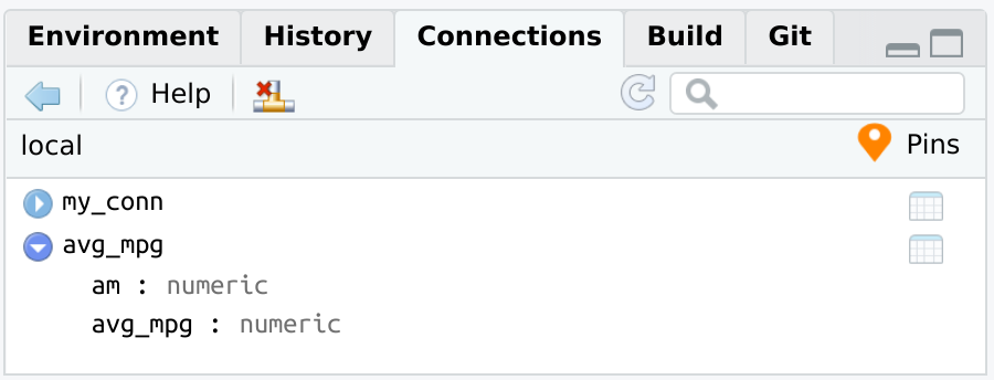

connection_pin_write(board, db_mtcars, name = "avg_mpg")
#> Creating new version '20231215T141203Z-41590'
#> Writing to pin 'avg_mpg'
connection_pin_read() will connect to the database, and return the dplyr object. Without assigning it to a variable, the pin will immediately print the results of the database. Those results are being processed at the time connection_pin_read() runs.
connection_pin_read(board, "avg_mpg")

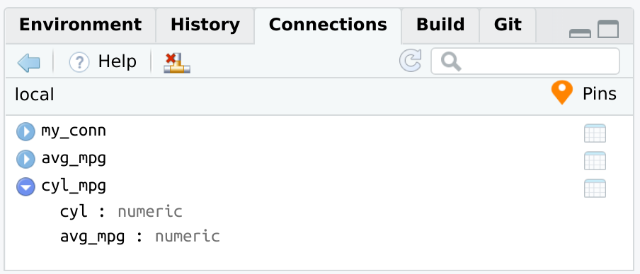

#> 2 1 24.4pins exampleThe way pins integrates with databases, via the connections package, allows to open the connection from a pin, and pipe all of the subsequent code into a new pin. Afterwards, that pin can be used to collect or to continue using the dplyr object.
con <- connection_pin_read(board, "my_conn")
tbl_summary <- con %>%
tbl("mtcars") %>%
group_by(cyl) %>%
summarise(avg_mpg = mean(mpg, na.rm = TRUE))
connection_pin_write(board, tbl_summary, name = "cyl_mpg")
#> Creating new version '20231215T141203Z-59396'
#> Writing to pin 'cyl_mpg'
connection_close(con)
connection_pin_read(board, "cyl_mpg")

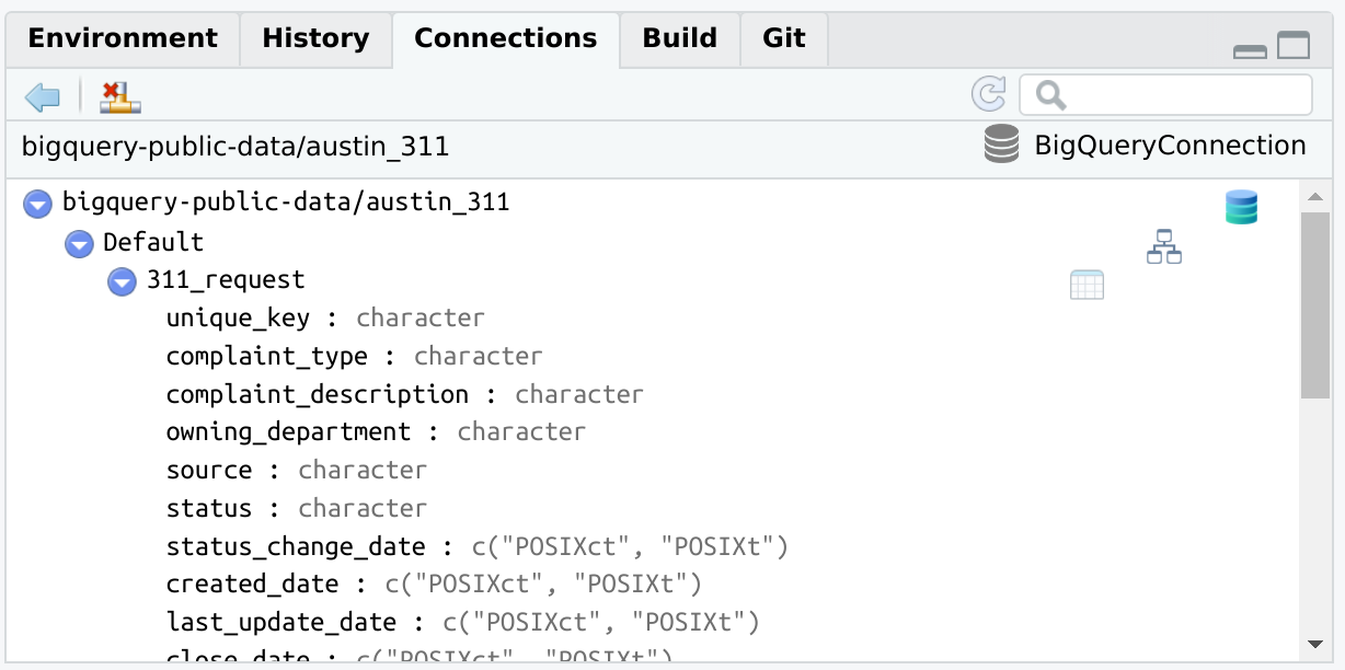

bigrquerylibrary(connections)
library(bigrquery)
bigquery(),
project = "bigquery-public-data",
dataset = "austin_311",
billing = "my_project_billing",
use_legacy_sql = FALSE

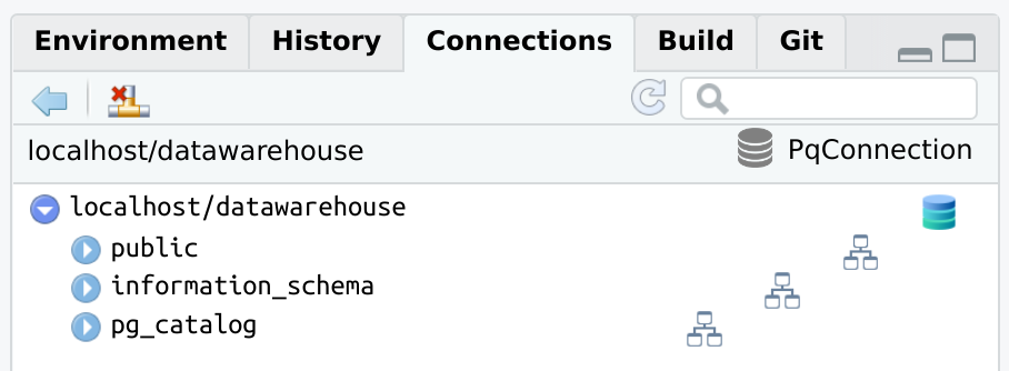

RPostgreslibrary(connections)
library(RPostgres)
Postgres(),
host = "localhost",
dbname = "datawarehouse",
user = "[user id]",
password = "[password]",
bigint = "integer",
port = "5432"
