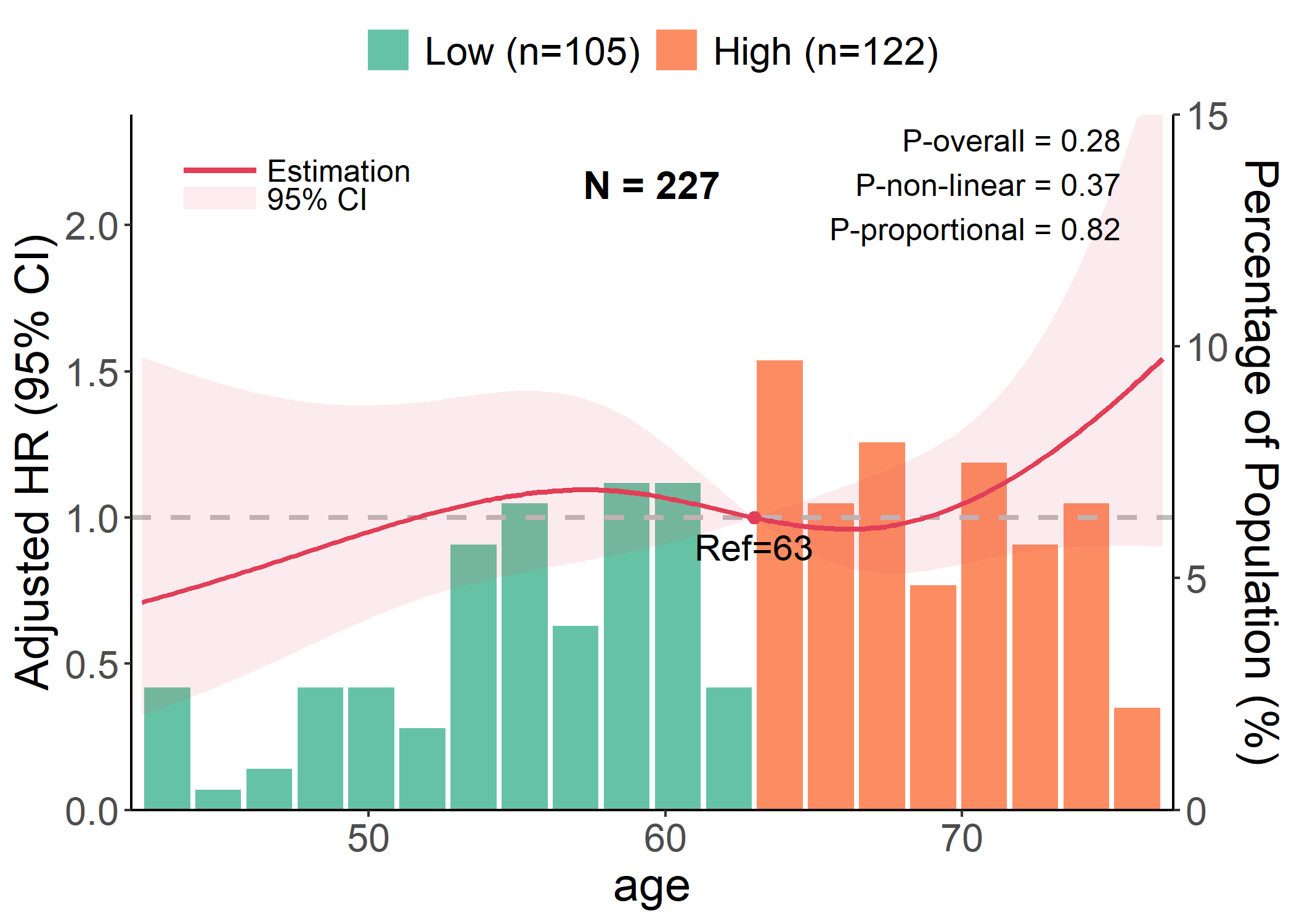

data(cancer, package = "survival")
# Performing cox regression, which is inferred by `y` and `time`
p <- rcs_plot(cancer, x = "age", y = "status", time = "time", covars = c("sex", "ph.karno"), save_plot = FALSE)
#> Warning in rcs_plot(cancer, x = "age", y = "status", time = "time", covars =
#> c("sex", : 1 incomplete cases excluded.
plot(p)

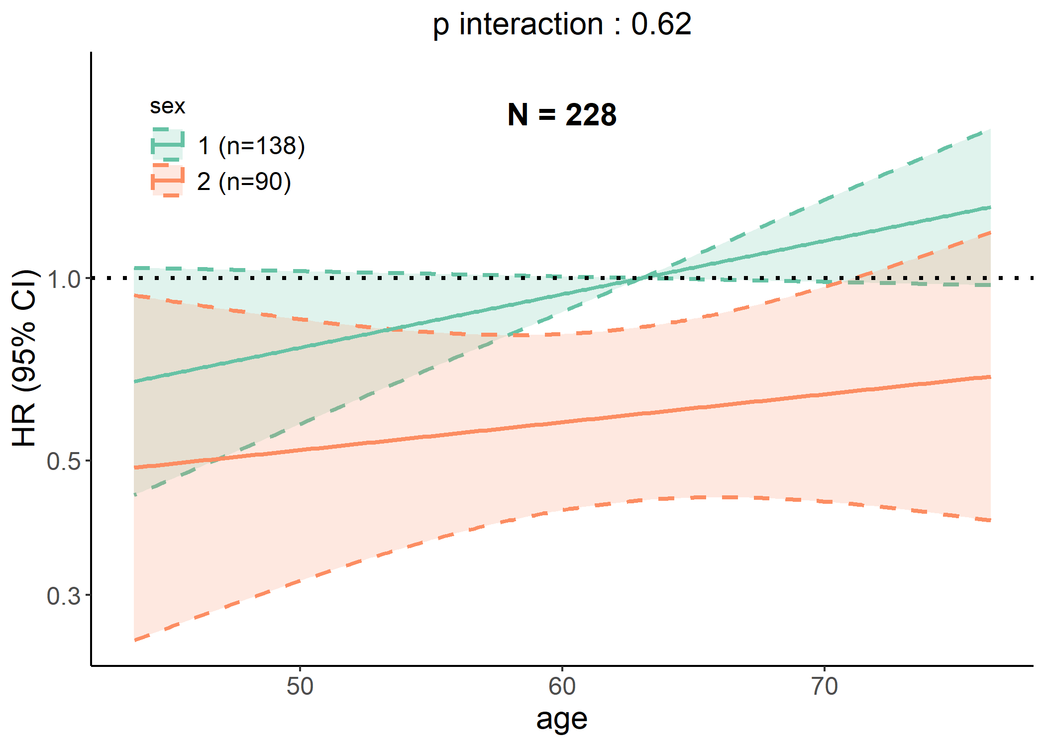

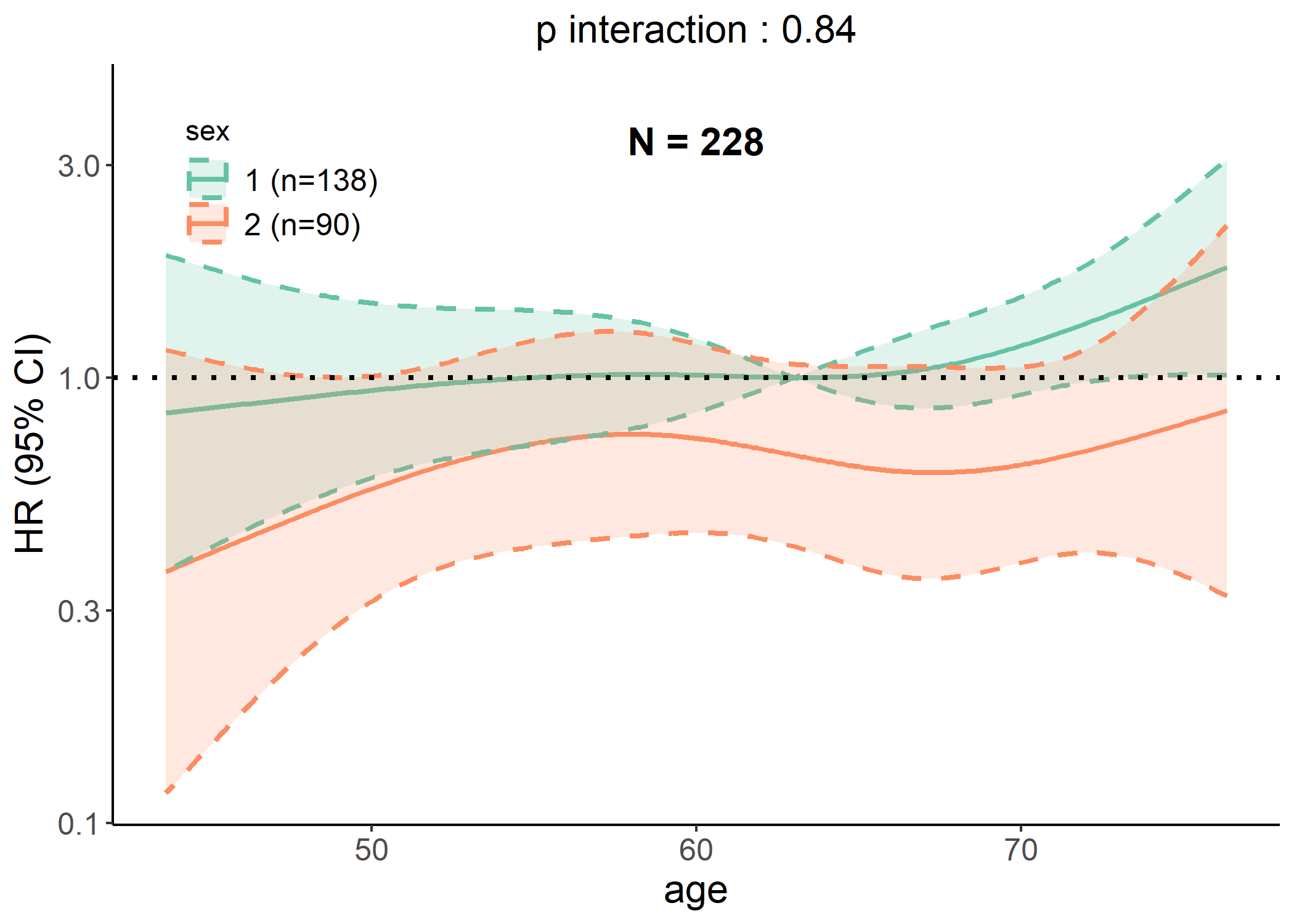

# Generating interaction plot of both linear and RCS models
p <- interaction_plot(cancer,
y = "status", time = "time", predictor = "age",
group_var = "sex", save_plot = FALSE
plot(p$lin)
plot(p$rcs)

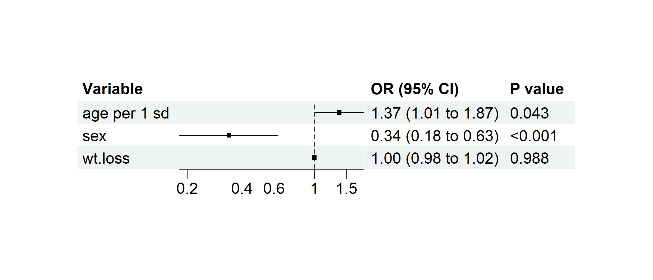

cancer$dead <- cancer$status == 2 # Preparing a binary variable for logistic regression
cancer$`age per 1 sd` <- c(scale(cancer$age)) # Standardizing age
# Performing multivairate logistic regression
p1 <- regression_forest(cancer,
model_vars = c("age per 1 sd", "sex", "wt.loss"), y = "dead",
as_univariate = FALSE, save_plot = FALSE
plot(p1)

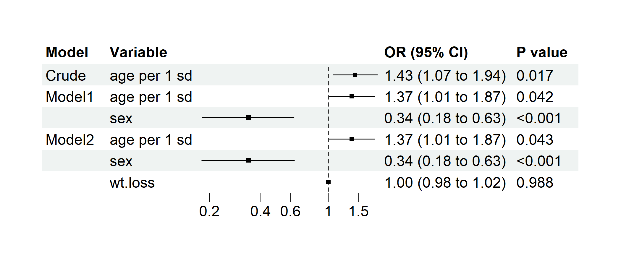

p2 <- regression_forest(
cancer,
model_vars = list(
Crude = c("age per 1 sd"),
Model1 = c("age per 1 sd", "sex"),
Model2 = c("age per 1 sd", "sex", "wt.loss")
y = "dead",
save_plot = FALSE
plot(p2)

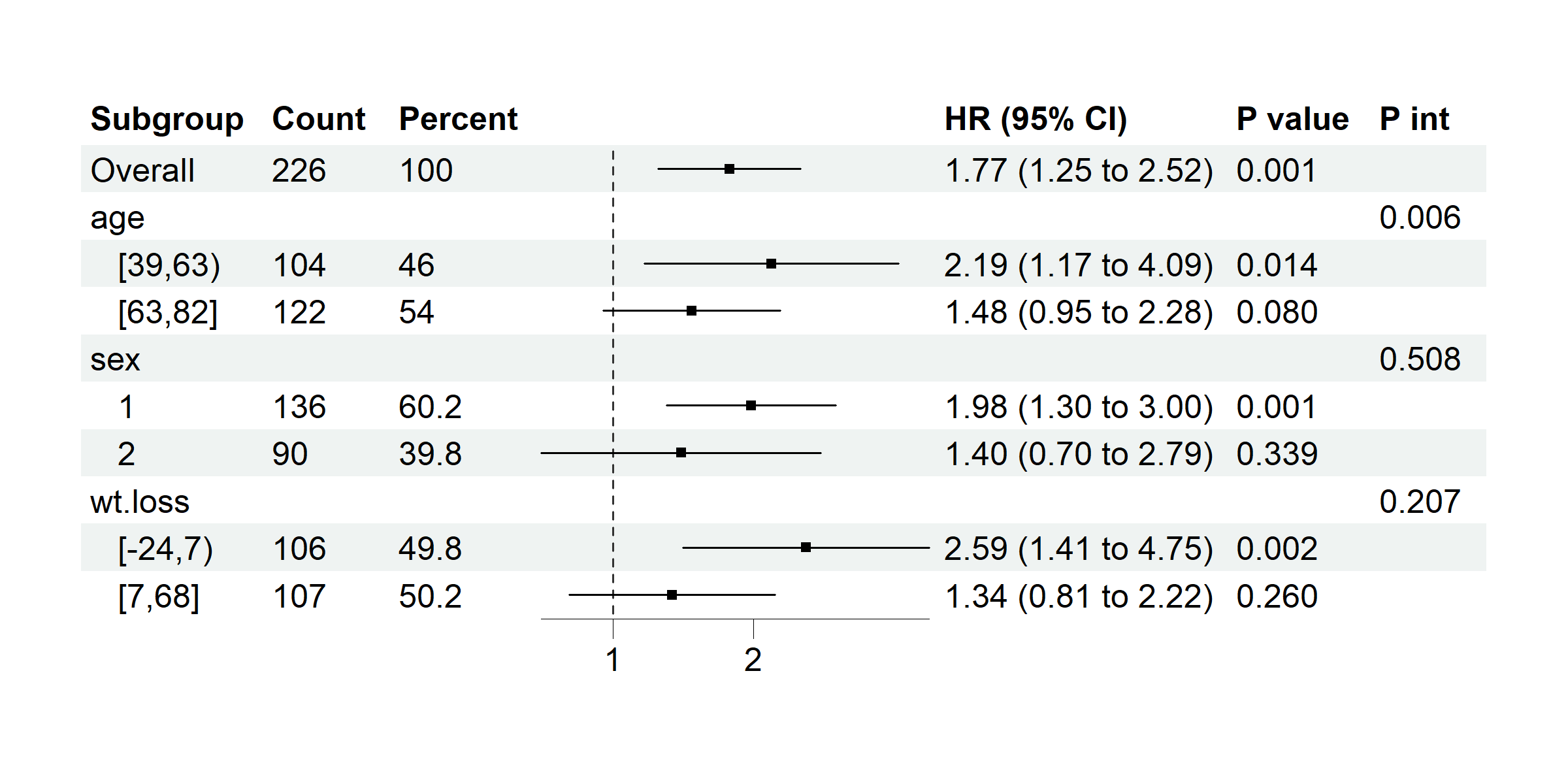

# coxph model with time assigned
p <- subgroup_forest(cancer,
subgroup_vars = c("age", "sex", "wt.loss"), x = "ph.ecog", y = "status",
time = "time", covars = "ph.karno", ticks_at = c(1, 2), save_plot = FALSE
plot(p)

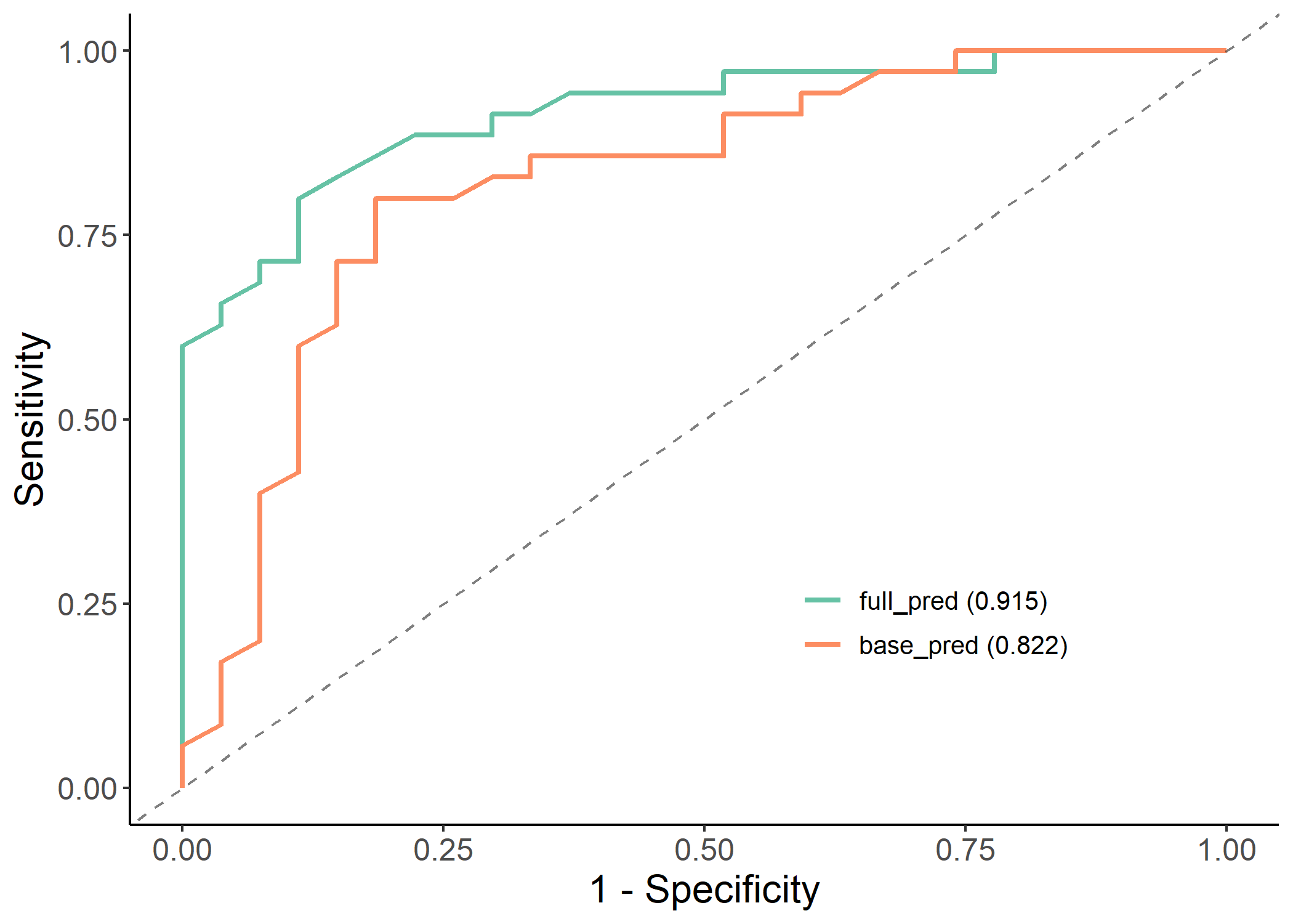

# Building models with example data
df <- kidney
df$dead <- ifelse(df$time <= 100 & df$status == 0, NA, df$time <= 100)
df <- na.omit(df[, -c(1:3)])
model0 <- glm(dead ~ age + frail, family = binomial(), data = df)
model1 <- glm(dead ~ ., family = binomial(), data = df)
df$base_pred <- predict(model0, type = "response")
df$full_pred <- predict(model1, type = "response")

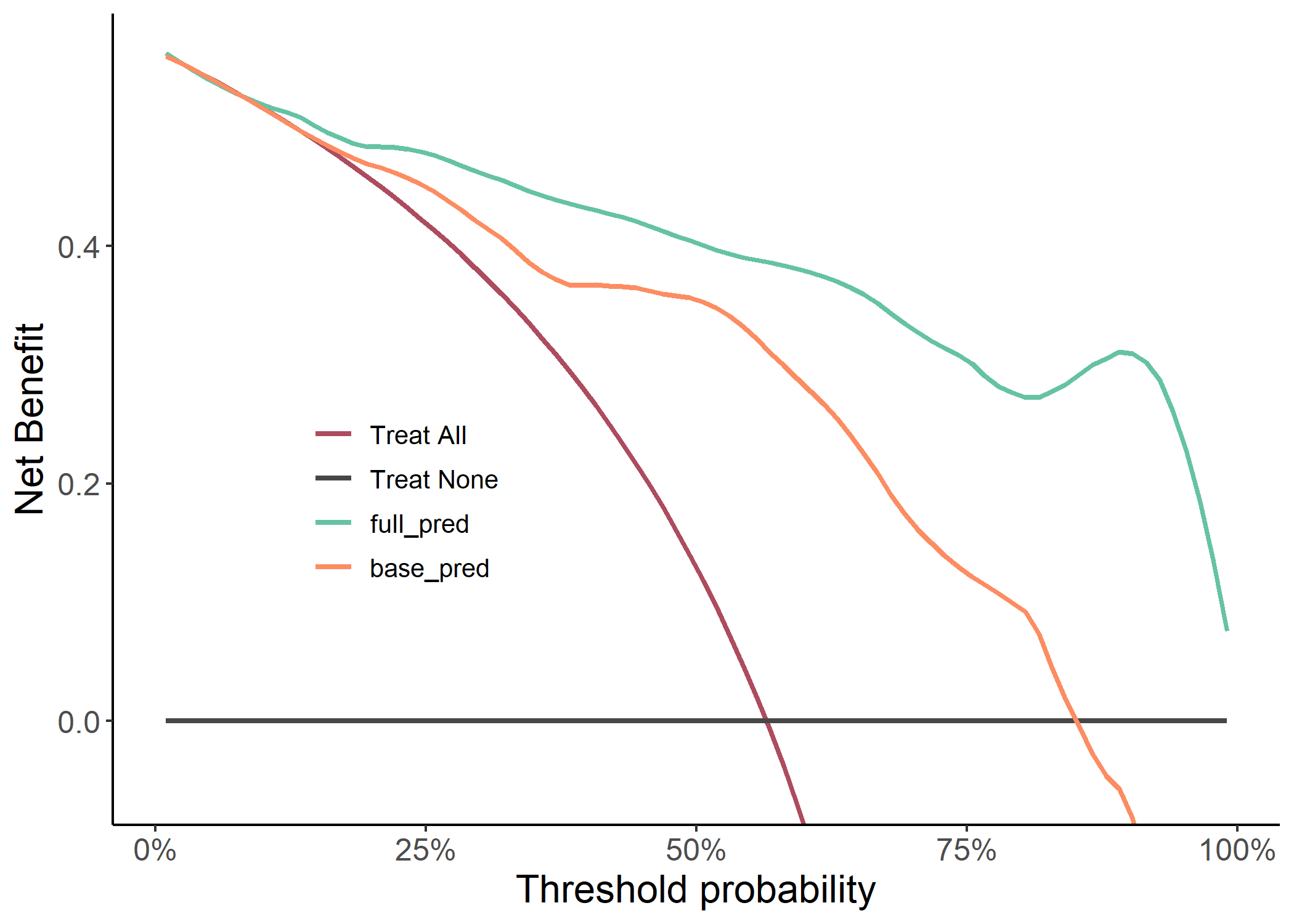

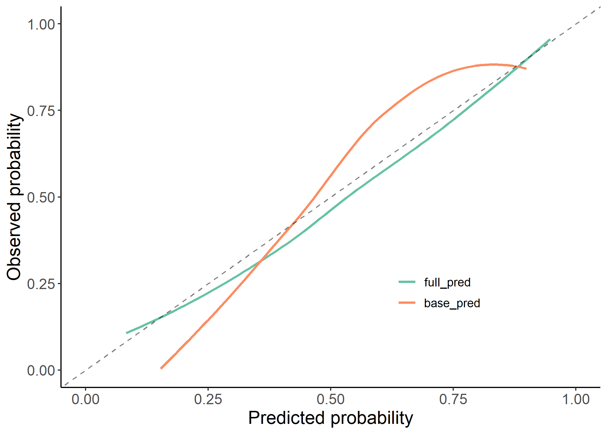

# Generating most of the useful plots and metrics for model comparison
results <- classif_model_compare(df, "dead", c("base_pred", "full_pred"), save_output = FALSE)
#> Assuming 'TRUE' is [Event] and 'FALSE' is [non-Event]
knitr::kable(results$metric_table)| Model | AUC | Accuracy | Sensitivity | Specificity | Pos Pred Value | Neg Pred Value | F1 | Kappa | Brier | cutoff | Youden | HosLem | |
| 2 | full_pred | 0.915 (0.847, 0.984) | 0.839 | 0.8 | 0.889 | 0.903 | 0.774 | 0.848 | 0.677 | 0.114 | 0.626 | 0.689 | 0.944 |
| 1 | base_pred | 0.822 (0.711, 0.933) | 0.806 | 0.8 | 0.815 | 0.848 | 0.759 | 0.824 | 0.610 | 0.171 | 0.490 | 0.615 | 0.405 |
plot(results$roc_plot)
plot(results$calibration_plot)
plot(results$dca_plot)

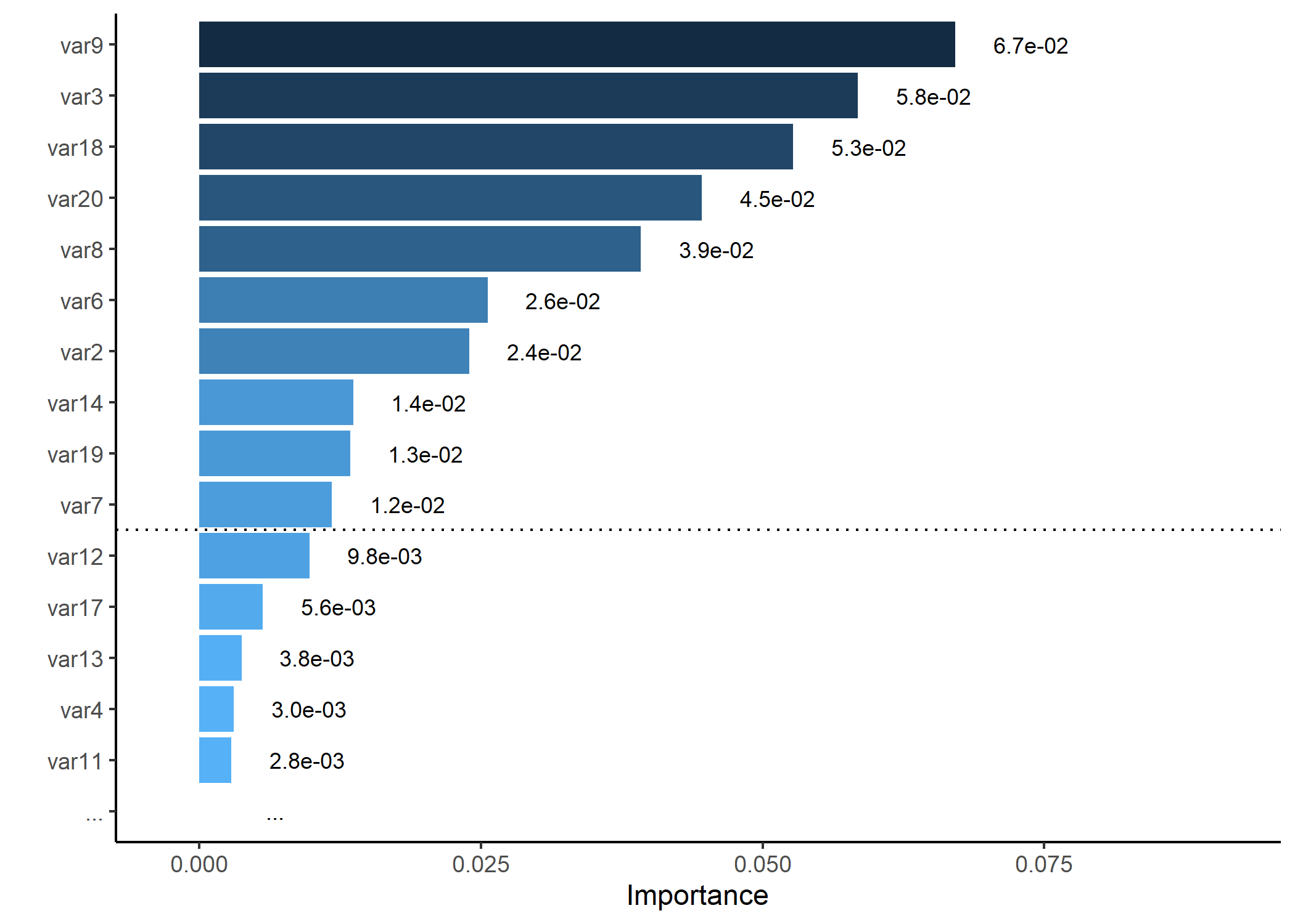

# Generating a dummy importance vector
set.seed(5)
dummy_importance <- runif(20, 0.2, 0.6)^5
names(dummy_importance) <- paste0("var", 1:20)
# Plotting variable importance, keeping only top 15 and splitting at 10
p <- importance_plot(dummy_importance, top_n = 15, split_at = 10, save_plot = FALSE)
plot(p)
#> Warning: Removed 1 row containing missing values or values outside the scale range
#> (`geom_bar()`).
