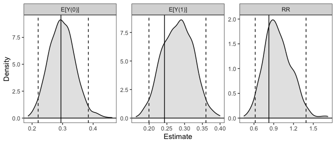

# View the estimates, confidence intervals, and p-values
summary(sim_est, null = c(`RR` = 1))
#> Estimate 2.5 % 97.5 % P-value
#> E[Y(0)] 0.294 0.220 0.384 .
#> E[Y(1)] 0.243 0.199 0.360 .
#> RR 0.826 0.619 1.391 0.79

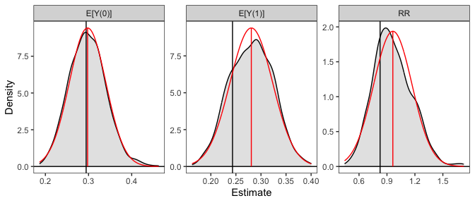

# Plot the resulting sampling distributions
plot(sim_est)
plot(sim_est, reference = TRUE, ci = FALSE)
The plot of the simulated sampling distribution indicates that the sampling distribution for the risk ratio is not normally distributed around the estimate, indicating that the delta method may be a poor approximation and the asymmetric confidence intervals produced using the simulation may be more valid. Note that the estimates are those computed from the original model coefficients; the distribution is used only for computing confidence intervals, in line with recommendations by Rainey (2023).

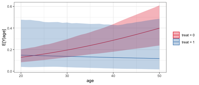

#> RD -0.0512 -0.1379 0.0927 0.79We can also use clarify to compute predictions and first differences at set and typical values of the predictors, mimicking the functionality of Zelig’s setx() and setx1() functions, using sim_setx():
# Predictions across age and treat at typical values
# of the other predictors
sim_est <- sim_setx(sim_coefs, x = list(age = 20:50, treat = 0:1),
verbose = FALSE)
#Plot of predicted values across age for each value of treat
plot(sim_est)
