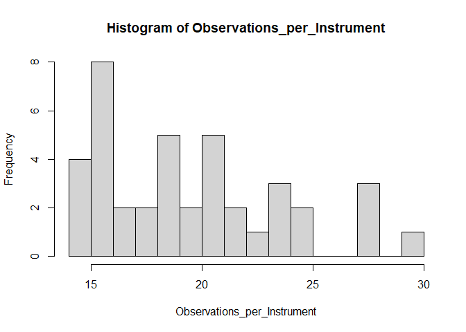

y <- D * tau_X[X] + U_V[, 1]In the generated sample, the observed instrument takes 40 values with varying numbers of observations per instrument:
