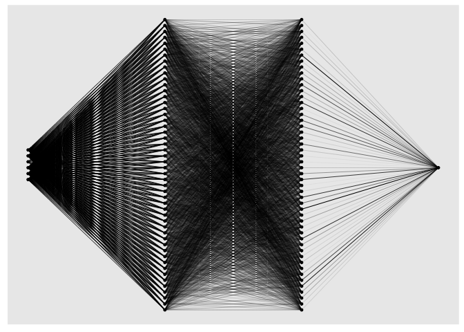

devtools::install_github('citoverse/cito')Once installed, the main function dnn() can be used. See the example below. A more in depth explanation can be found in the vignettes or here under articles.
