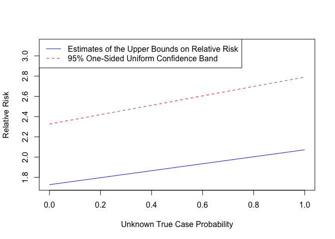

estimates of the cicc_RR command are based on the scale of
log relative risk. It is more conventional to look at the results in
terms of relative risk. To do so, we plot the results in the following
way:
cicc_plot(results)
To interpret the results, we assume both marginal treatment response (MTR) and marginal treatment selection (MTS). In this setting, MTR means that everyone will not earn less by obtaining a degree higher than bachelor’s degree; MTS indicates that those who selected into higher education have higher potential to earn top incomes. Based on the MTR and MTS assumptions, we can conclude that the treatment effect lies in between 1 and the upper end point of the one-sided confidence interval with high probability. Thus, the estimates in the graph above suggest that the effect of obtaining a degree higher than bachelor’s degree is anywhere between 1 and the upper end points of the uniform confidence band. This roughly implies that the chance of earning top incomes may increase up to by a factor as large as the upper end points of the uniform confidence band, but allowing for possibility of no positive effect at all. The results are shown over the range of the unknown true case probability. See Jun and Lee, 2020 for more detailed explanations regarding how to interpret the estimation results.
