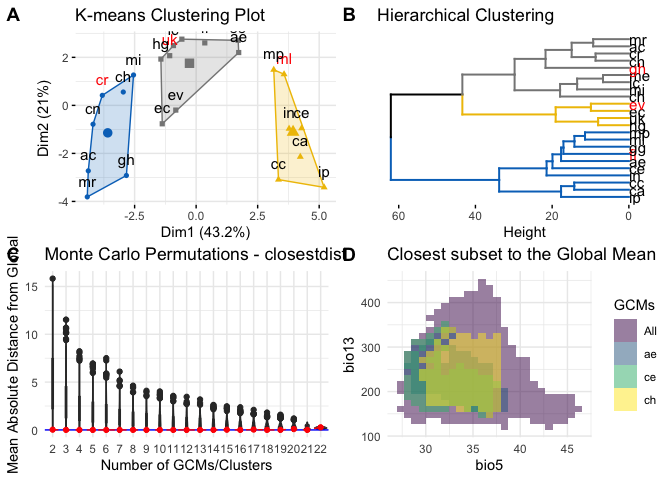

The aim of this function is to inform the minimum required so users
can follow with their workflow in a more straightforward fashion (more

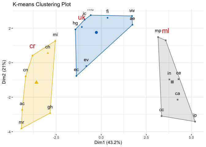

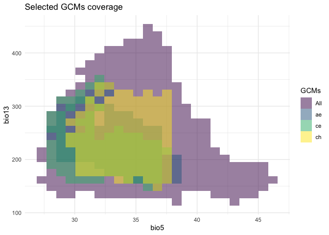

on each plot further). If we see the D plot in the Figure, we can infer
if the selected GCMs encompass the environmental variety of all GCMs.
The focus should be to cover the core environment and not outlier

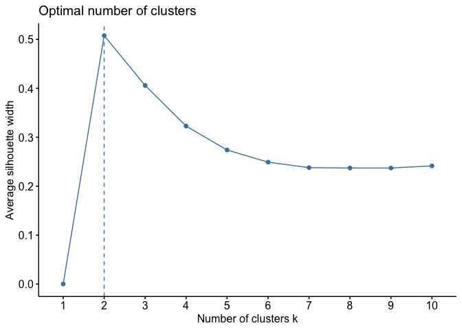

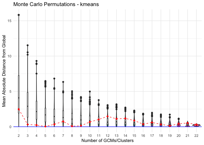

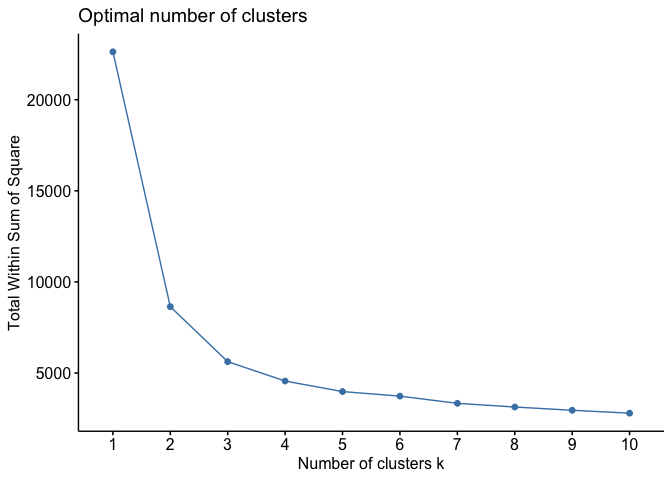

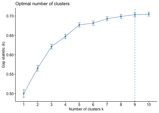

regions on the environmental space. Above that, in plot B, the Monte
Carlo permutation between GCMs is presented as a violin plot. Plots A
and C are both clusterization methods that can be used to select GCMs.
Clusterization will be adapted to the number of clusters k
designated in the function. Lastly, suggested GCMs were “uk”, “ml” and
“ac”. Those suggestions are the gcms that are closer to the centroid of
each K-means cluster, thus they better represent the variation within
each cluster.

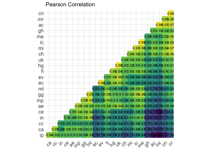

#> bio15 708Regarding the exploratory comparison between GCMs, two functions are
available: cor_gcms and dist_gcms. The first
is designed to return a list with a correlation matrix between GCMs and
a plot of this matrix. We noticed while building this package that (as
expected) Pearson correlation values are always very high, rarely
reaching values bellow 0.95. In this way we found that this function
could not be so informative and decided to present a distance function
as seen bellow. However it is noteworthy that through this function the
user can change the method used to obtain correlation values. See
?cor_gcms for available methods.
# Pearson Correlation between GCMs
s_cor <- cor_gcms(s, var_names, study_area_parana, scale = TRUE, method = "pearson")
#> CRS from s and study_area are not identical. Reprojecting study area.
#> Scale for fill is already present.
#> Adding another scale for fill, which will replace the existing scale.
s_cor
#> $cor_matrix
#> ac ae ca cc ce ch cn
#> ac 1.0000000 0.8222687 0.7474311 0.7774549 0.7167943 0.9268093 0.9705559
#> ae 0.8222687 1.0000000 0.9075920 0.8684687 0.9056885 0.8965440 0.8660992
#> ca 0.7474311 0.9075920 1.0000000 0.9521852 0.9178031 0.8053916 0.7686080
#> cc 0.7774549 0.8684687 0.9521852 1.0000000 0.8748224 0.8134863 0.7971570
#> ce 0.7167943 0.9056885 0.9178031 0.8748224 1.0000000 0.8312629 0.7644923
#> ch 0.9268093 0.8965440 0.8053916 0.8134863 0.8312629 1.0000000 0.9490186
#> cn 0.9705559 0.8660992 0.7686080 0.7971570 0.7644923 0.9490186 1.0000000
#> cr 0.9691325 0.8842913 0.8096930 0.8327782 0.7979551 0.9630363 0.9822591

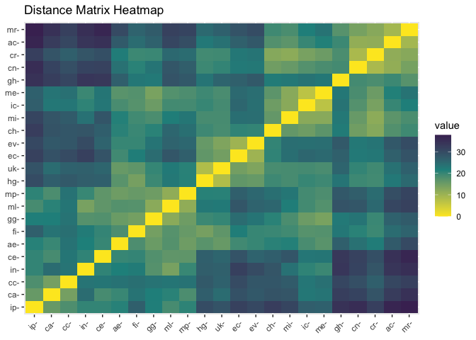

The function dist_gcms is very similar to the previous
cor_gcms, but now for distances. This function has the same
output: a list with two slots. One is the distance matrix obtained
(distances), while the second is the plotted matrix
(heatmap). Here the differences between GCMs are way more
clear than in the previous plot. As in was it the previous function,
methods can also be changed for a number of different distances. For a
complete list of available methods see ?dist_gcms. To build
a distance matrix considering multiple variables to each GCM we use a
flattening strategy, where values are concatenated in one unique vector
to each GCM. In the process, we need to scale variables so they end up
with the same measure. This matrix is also used to calculate the
clusters in the compare_gcms function and in further
presented kmeans_gcms function.
# Euclidean Distance between GCMs
s_dist <- dist_gcms(s, var_names, study_area_parana, method = "euclidean")
s_dist

#> $heatmap

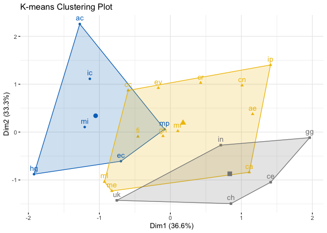

Clusters in chooseGCM are obtained through K-means, a unsupervised
machine learning algorithm. K in this case is the number of GCMs the
modeler wants to use in projections. As in the previous
dist_gcms function, we can address different methods to
obtain the distance matrix by changing the method argument.
The K-means algorithm uses the distance matrix to obtain clusters, thus
a deep analysis of distances using dist_gcms function could
prove to be useful. As in compare_gcms function, this
function returns the K-means plot and a set of suggested GCMs, i.e. the
GCMs closer to the centroid of each clusters.
kmeans_gcms(s, var_names, study_area_parana, k = 3, method = "euclidean")
#> $suggested_gcms
#> 1 2 3
#> "uk" "cr" "ml"
#> $kmeans_plot
Alternatively, instead of using distances, one could run the analysis with raw environmental data by not setting any value to method (note how axis change). As in the previous case, the function also returns GCMs that are closer to the centroids. Note however that the plot below has a cluster with two GCMs, thus both have the same distance from the centroid. In this case, the function randomly suggests one of them. To perform this analysis without a distance matrix, we use only the mean values of each variable selected. In this way, the variability within variables is not considered, as in the above solution. But we recognize that for some purpose it could be useful to have a plot with raw variables as axis as provided here.
kmeans_gcms(s, var_names, study_area_parana, k = 3)
#> $suggested_gcms
#> [1] "ic" "gh" "in"
#> $kmeans_plot

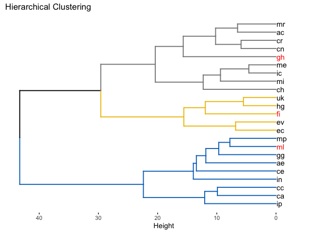

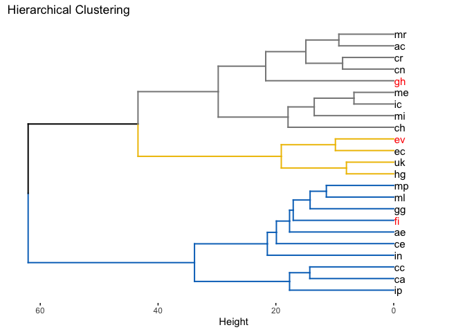

We can also obtain clusters through hierarchical clustering. In this case, however, the function doesn’t suggest any GCM. It is up to the user to define which GCMs are most suitable in this case. Hierarchical clustering is useful to visually inform the relationship between groups and could also be used to choose a number of clusters to build (together with metrics in the next section).
hclust_gcms(s, var_names, study_area_parana, k = 3)
#> $suggested_gcms
#> [1] "gh" "fi" "ev"
#> $dend_plot
In this function we also provide a n argument to inform
the amount of data to be used in the clustering. This proved valuable
when using high resolution data.
hclust_gcms(s, var_names, study_area_parana, k = 3, n = 1000)
#> $suggested_gcms
#> [1] "gh" "ml" "fi"
#> $dend_plot

method argument. Within-cluster sum of squares (wss)
calculates the internal variability within clusters. Our goal here is to
search for the minimum amount of clusters that has the minimum amount of
variability. This is shown in the graph were the line changes abruptly
its direction (Number of clusters k = 3). As in the previous function,
this function provides a n argument to inform the amount of
data to be used in the clustering. Finally, one can also indicate the
method to build clusters with the argument clusters.
Available methods are ‘kmeans’ (standard) and ‘hclust’.
optk_gcms(s, var_names, study_area_parana, cluster = "kmeans", method = "wss", n = 1000)

The Average Silhouette Width method, measures the mean distance from all individuals to the centroid of their own clusters, while comparing to other clusters. This is sometimes also referred as a metric of cluster quality (the higher the better). A number of clusters is the best when the distance from individuals within the cluster to its centroid is lower than the distance from individuals to other clusters centroid (maximizing the average silhouette width). In this method, the best number of clusters is marked with a dashed line (2 clusters).
optk_gcms(s, var_names, study_area_parana, cluster = "kmeans", method = "silhouette", n = 1000)
Our last method is the Gap Statistics. As in the previous method,
here the optimum number of clusters is showed with a dashed line (1
cluster). This method compares the variation within clusters with a set
of null clusters build through Monte Carlo (“bootstrap”) sampling.
Because of that, the gap statistics can take a longer time to run when
compared to previous methods described here. Moreover, some parameters
can be changed to improve the Monte Carlo process, such as:
nstart, K.max and B, where
nstart is the initial number of arrangements to be
compared, K.max is the maximum number of clusters to be
created and B is the number of bootstrap permutations.
optk_gcms(s, var_names, study_area_parana, cluster = "kmeans", method = "gap_stat", n = 1000)

An alternative way to analyse if the mean distance between GCMs is
similar to the mean distance between all GCMs is to use the
montecarlo_gcms function. This function will build a
distance matrix (using method argument) and plot the mean
distance between all GCMs as a blue line. Afterwards, it will run a
Monte Carlo permutation to randomly choose a group size ranging from [2]
and [total number of GCMs - 1] and randomly choose a subset of GCMs with
that group size. The mean distance between the random set is obtained
and ploted in a violin plot. Finally, the function accesses the mean
distance between selected GCMs using the kmeans function in all possible
values of k and plots it in red.
montecarlo_gcms(s, var_names, study_area_parana, perm = 10000, dist_method = "euclidean", clustering_method = "kmeans")

As a way to optimize GCMs selection, we implemented a greedy algorithm, which calculates the distance matrix between all GCMs and calculates the mean distance in the matrix (global mean distance). The algorithm selects a random pair of GCMs and test if adding any other GCM to that pair will drive the mean distance closer to the global mean. The algorithm stops when adding a new GCM does not return a mean distance closer to the global mean or when the distance reaches a minimum value (standard = 0.0000001).
closestdist_gcms(s, var_names, study_area_parana)
#> $suggested_gcms
#> [1] "ae" "cc" "hg" "mi" "ec" "ml"
#> $best_mean_diff
#> [1] 3.028944e-05
#> $global_mean
#> [1] 22.5668We can also provide the value of k we want to use:
closestdist_gcms(s, var_names, study_area_parana, k=3)
#> $suggested_gcms
#> [1] "ae" "ce" "ch"
#> $best_mean_diff
#> [1] 0.001482039
#> $global_mean
#> [1] 22.5668From our analysis, we can infer that something between two and three clusters is enough to inform regarding the environmental variation from given GCMs. In this way, if we use GCMs CNRM-ESM2-1 (cr), MPI-ESM1-2-LR (ml) and UKESM1-0-LL (uk) to project our models into future scenarios we would be able to inform a decent variation in our projections.
