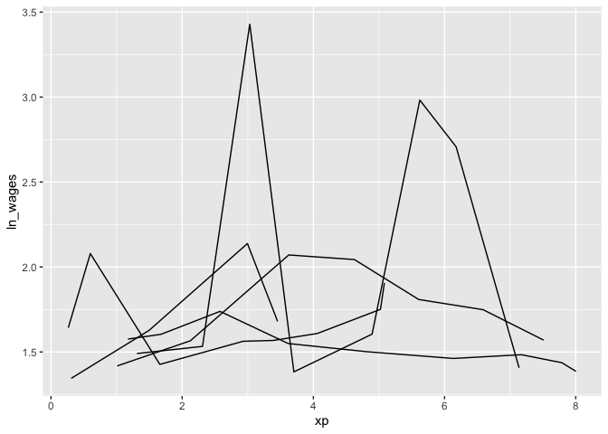

sample_n_keys()In dplyr, you can use sample_n() to sample n observations, or sample_frac() to look at a fraction of observations.
brolgar builds on this providing sample_n_keys() and sample_frac_keys(). This allows you to take a random sample of n keys using sample_n_keys(). For example:
set.seed(2019-7-15-1300)
wages %>%
sample_n_keys(size = 5) %>%
ggplot(aes(x = xp,
y = ln_wages,
group = id)) +
geom_line()

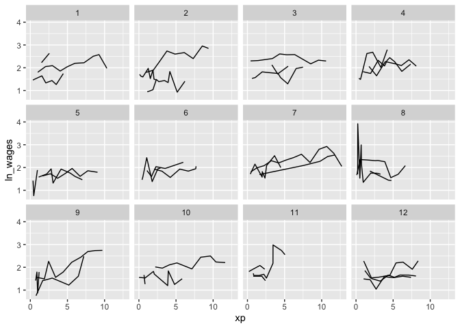

And what if you want to create many of these plots?
facet_sample()facet_sample() allows you to specify the number of keys per facet, and the number of facets with n_per_facet and n_facets.
By default, it splits the data into 12 facets with 5 per facet:
set.seed(2019-07-23-1937)
ggplot(wages,
aes(x = xp,
y = ln_wages,
group = id)) +
geom_line() +
facet_sample()
Under the hood, facet_sample() is powered by sample_n_keys() and stratify_keys().

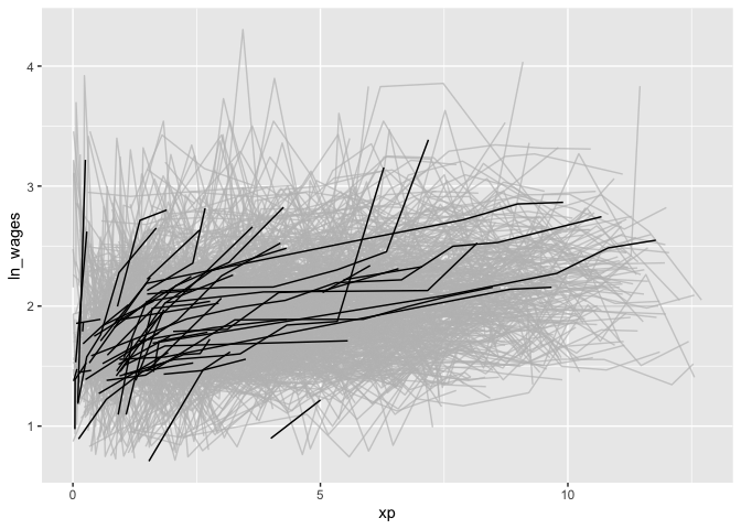

Once you have created these features, you can join them back to the data with a left_join, like so:
wages %>%
features(ln_wages, feat_monotonic) %>%
left_join(wages, by = "id") %>%
ggplot(aes(x = xp,
y = ln_wages,
group = id)) +
geom_line() +
gghighlight(increase)
#> Warning: Tried to calculate with group_by(), but the calculation failed.
#> Falling back to ungrouped filter operation...
#> label_key: id
#> Too many data series, skip labeling

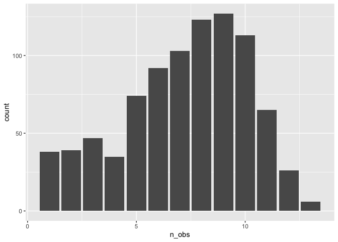

n_obs()Return the number of observations total with n_obs():
n_keys()And the number of keys in the data using n_keys():
key.You can also use n_obs() inside features to return the number of observations for each key:
wages %>%
features(ln_wages, n_obs)
#> # A tibble: 888 × 2
#> id n_obs
#> <int> <int>
#> 1 31 8
#> 2 36 10
#> 3 53 8
#> 4 122 10
#> 5 134 12
#> 6 145 9
#> 7 155 11
#> 8 173 6
#> 9 206 3
#> 10 207 11
#> # ℹ 878 more rowsThis returns a dataframe, with one row per key, and the number of observations for each key.
This could be further summarised to get a sense of the patterns of the number of observations:
wages %>%
features(ln_wages, n_obs) %>%
summary()
#> id n_obs
#> Min. : 31 Min. : 1.000
#> 1st Qu.: 3332 1st Qu.: 5.000
#> Median : 6666 Median : 8.000
#> Mean : 6343 Mean : 7.209
#> 3rd Qu.: 9194 3rd Qu.: 9.000
#> Max. :12543 Max. :13.000brolgar provides other useful functions to explore your data, which you can read about in the exploratory modelling and Identify Interesting Observations vignettes. As a taster, here are some of the figures you can produce:
