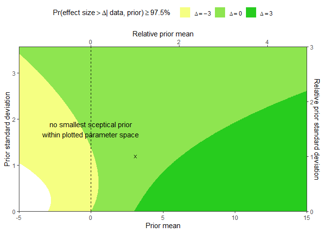

The following code extends the example from Hoefler and Miller (2023) by visualizing the RoE for one non-inferiority claim (delta = -3 pts) and the ROEs for two superiority claims (delta = 0 points and delta = 3 points) for an additional reduction of MADRS scores due to adjunct Esketamine treatment of patients suffering from moderate to severe major depression:
library(bayesROE)
# Arguments to reproduce Figure from Hoefler and Miller (2023)
init <- list(ee = 3.07, se = 1.19, delta = c(-3, 0, 3), alpha = 0.025, sceptPrior = 0)
cols <- list(col_lower = "#F5FF82", col_upper = "#27CC1E")
# Pass Arguments to Locally Run Shiny Application using run_app()
if(interactive()){
run_app(init = init, cols = cols)
# Alternatively Generate and Customize Regions of Evidence Plot using ribbonROE()
HM23.3 <- ribbonROE(ee = init$ee, se = init$se, delta = init$delta, alpha = init$alpha,
sceptPrior = init$sceptPrior,
cols = c(cols$col_lower, cols$col_upper))$plot +
ggplot2::annotate(geom = "point", y = init$ee, x = init$se, shape = 4) +
ggplot2::coord_flip(ylim = c(-5, 15))
#> Coordinate system already present. Adding new coordinate system, which will
#> replace the existing one.The resulting RoE plot enables to evaluate the presence of the respective claim (colored areas) or their absence (white area) as a function of prior expected mean (x-axis) and prior standard deviation (y-axis) that could be used by an assessor. The cross marks the effect estimate that was used to construct the RoE. The dashed vertical line represents all the sceptical priors that assume the true effect around 0, with a varying degree of uncertainty.
