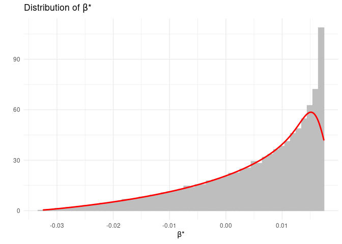

and quantiles of the BATE (computed over the bounded box we chose above).
(OVB$bstar_Distribution)
#>   2.5%     5%    50%    95%  97.5%
#> -0.021 -0.017  0.009  0.017  0.017
We can create the histogram and density plot of the omitted variable bias.
bate::dplotbate(OVB$Data)

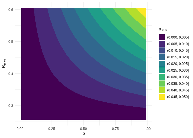

We can also create a contour plot of BATE over the bounded box.
bate::cplotbias(OVB$Data)
