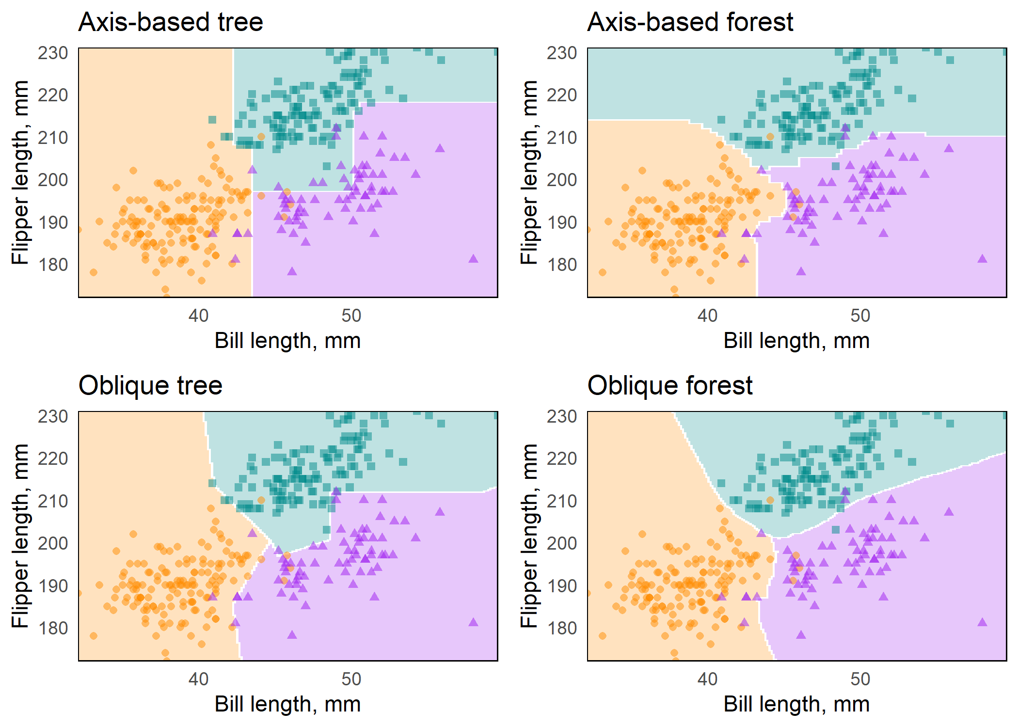

#> -----------------------------------------Decision trees are grown by splitting a set of training data into non-overlapping subsets, with the goal of having more similarity within the new subsets than between them. When subsets are created with a single predictor, the decision tree is axis-based because the subset boundaries are perpendicular to the axis of the predictor. When linear combinations (i.e., a weighted sum) of variables are used instead of a single variable, the tree is oblique because the boundaries are neither parallel nor perpendicular to the axis.
Figure: Decision trees for classification with axis-based splitting (left) and oblique splitting (right). Cases are orange squares; controls are purple circles. Both trees partition the predictor space defined by variables X1 and X2, but the oblique splits do a better job of separating the two classes.
So, how does this difference translate to real data, and how does it impact random forests comprising hundreds of axis-based or oblique trees? We will demonstrate this using the penguin data.3 We will also use this function to make several plots:
plot_decision_surface <- function(predictions, title, grid){
# this is not a general function for plotting
# decision surfaces. It just helps to minimize
# copying and pasting of code.
class_preds <- bind_cols(grid, predictions) %>%
pivot_longer(cols = c(Adelie,
Chinstrap,
Gentoo)) %>%
group_by(flipper_length_mm, bill_length_mm) %>%
arrange(desc(value)) %>%
slice(1)
cols <- c("darkorange", "purple", "cyan4")
ggplot(class_preds, aes(bill_length_mm, flipper_length_mm)) +
geom_contour_filled(aes(z = value, fill = name),
alpha = .25) +
geom_point(data = penguins_orsf,
aes(color = species, shape = species),
alpha = 0.5) +
scale_color_manual(values = cols) +
scale_fill_manual(values = cols) +
labs(x = "Bill length, mm",
y = "Flipper length, mm") +
theme_minimal() +
scale_x_continuous(expand = c(0,0)) +
scale_y_continuous(expand = c(0,0)) +
theme(panel.grid = element_blank(),
panel.border = element_rect(fill = NA),
legend.position = '') +
labs(title = title)
}We also use a grid of points for plotting decision surfaces:
grid <- expand_grid(
flipper_length_mm = seq(min(penguins_orsf$flipper_length_mm),
max(penguins_orsf$flipper_length_mm),
len = 200),
bill_length_mm = seq(min(penguins_orsf$bill_length_mm),
max(penguins_orsf$bill_length_mm),
len = 200)
)We use orsf with mtry=1 to fit axis-based trees:
fit_axis_tree <- penguins_orsf %>%
orsf(species ~ bill_length_mm + flipper_length_mm,
n_tree = 1,
mtry = 1,
tree_seeds = 106760)Next we use orsf_update to copy and modify the original model, expanding it to fit an oblique tree by using mtry=2 instead of mtry=1, and to include 500 trees instead of 1:
fit_axis_forest <- fit_axis_tree %>%
orsf_update(n_tree = 500)
fit_oblique_tree <- fit_axis_tree %>%
orsf_update(mtry = 2)
fit_oblique_forest <- fit_oblique_tree %>%
orsf_update(n_tree = 500)And now we have all we need to visualize decision surfaces using predictions from these four fits:
preds <- list(fit_axis_tree,
fit_axis_forest,
fit_oblique_tree,
fit_oblique_forest) %>%
map(predict, new_data = grid, pred_type = 'prob')
titles <- c("Axis-based tree",
"Axis-based forest",
"Oblique tree",
"Oblique forest")
plots <- map2(preds, titles, plot_decision_surface, grid = grid)Figure: Axis-based and oblique decision surfaces from a single tree and an ensemble of 500 trees. Axis-based trees have boundaries perpendicular to predictor axes, whereas oblique trees can have boundaries that are neither parallel nor perpendicular to predictor axes. Axis-based forests tend to have ‘step-function’ decision boundaries, while oblique forests tend to have smooth decision boundaries.
