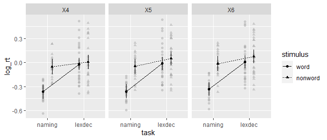

afex_plotANOVA models can be used for plotting via afex_plot:
a <- aov_ez("id", "log_rt", fhch, between = "task", within = c("stimulus", "length"))
#> Warning: More than one observation per design cell, aggregating data using `fun_aggregate = mean`.
#> To turn off this warning, pass `fun_aggregate = mean` explicitly.afex_plot(a, "task", "stimulus", "length")
#> Warning: Panel(s) show a mixed within-between-design.
#> Error bars do not allow comparisons across all means.
#> Suppress error bars with: error = "none"

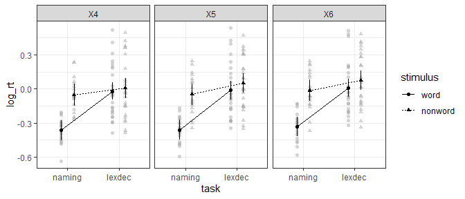

afex_plot returns a ggplot2 plot object
which allows simple customization:
library("ggplot2")
afex_plot(a, "task", "stimulus", "length") +
theme_bw()

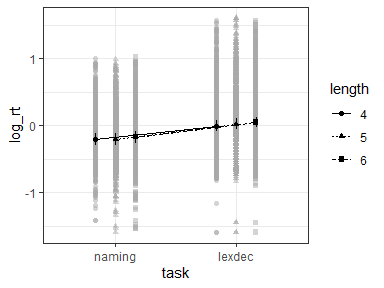

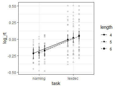

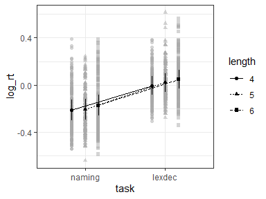

#> Signif. codes: 0 '***' 0.001 '**' 0.01 '*' 0.05 '+' 0.1 ' ' 1afex_plotObjects returned by mixed can be used for plotting with
afex_plot. However, two things need to be considered.
id argument of afex_plot allows
specifying over which random effects grouping factors the data plotted
in the background should be averaged over. Per default this uses all
random effects grouping factors. In the present case this would mean
that all data points are shown resulting in a very busy plot. When
choosing only one of the random effects grouping factor, data points in
the background show average response for each level of that factor. For
example, when setting id = "id" here each data point in
the background shows the mean log_rt of one participant
(i.e., level of id).emmeans which per default attempts to estimate the degrees
of freedom using the expensive Kenward-Roger method unless the number of
data points is high (as here). This can produce quite some status
messages (not shown here). Use
emmeans::emm_options(lmer.df = "asymptotic") to suppress
this calculation.library("ggplot2")
## all data points shown
afex_plot(m3, "task", "length") +
theme_bw()
## data points show IDs
afex_plot(m3, "task", "length", id = "id") +
theme_bw()
## data points show items
afex_plot(m3, "task", "length", id = "item") +
theme_bw()
