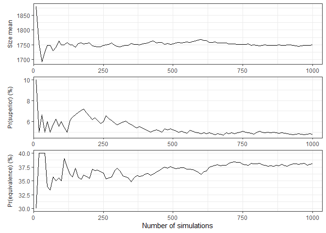

Several visualisation functions are included (all are optional, and all require the ggplot2 package installed).
Convergence and stability of one or more performance metrics may be visually assessed using plot_convergence() function:
plot_convergence(
calibrated_binom_trial$best_sims,
metrics = c("size mean", "prob_superior", "prob_equivalence"),
# select_strategy can be specified, but does not affect the chosen metrics

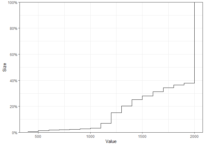

The empirical cumulative distribution functions for continuous performance metrics may also be visualised:

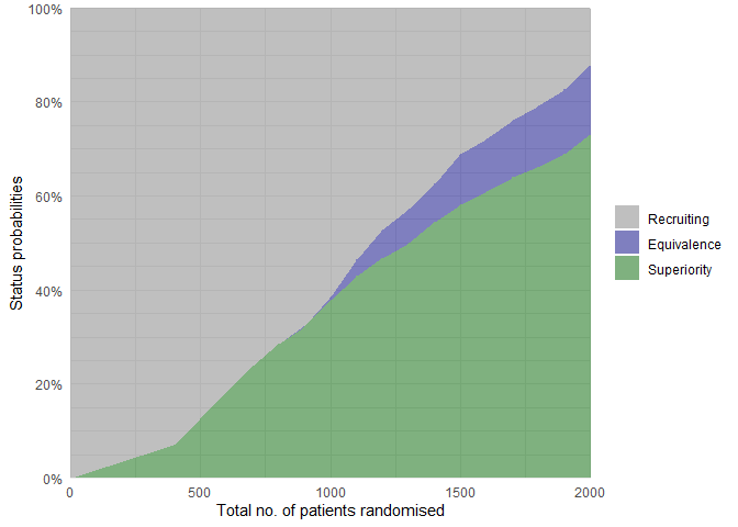

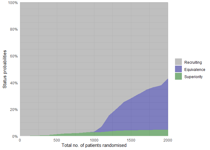

The status probabilities for the overall trial (or for specific arms) according to trial progress can be visualised using the plot_status() function:
# Overall trial status probabilities
plot_status(
x_value = "total n" # Total number of randomised patients at X-axis

Similarly, overall trial statuses for the scenario with differences can be visualised:
