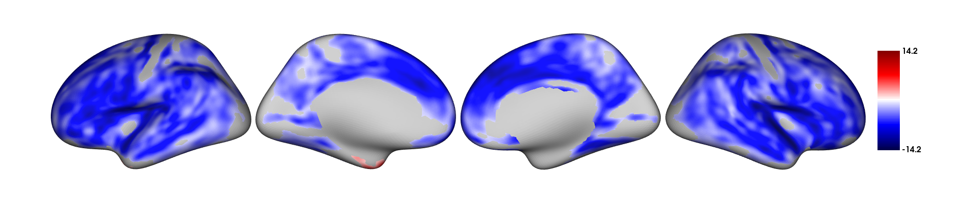

results=RFT_vertex_analysis(model = all_pred, contrast =all_pred$age, surf_data = SPRENG_CTv, atlas = 1)
print(results$cluster_level_results)## $`Positive contrast`
## clusid nverts P X Y Z tstat region
## 1 1 142 0.015 -22.8 11.5 -42 6.45 lh-temporalpole
## $`Negative contrast`
## 1 1 8039 <0.001 47 4.0 -16.6 -12.64 rh-superiortemporal
## 2 2 7660 <0.001 -34 -25.7 16.2 -14.23 lh-insula
In the above results, the clusters that appear under the
Positive contrast section are clusters of vertices which
correlate positively with your contrast variable,
vice-versa for the Negative contrast.
nverts: number of vertices in the cluster
P: p-value of the cluster
X, Y and Z: MNI coordinates of the vertex with the
highest t-stat in the cluster
tstat: t statistic of the vertex with the highest
region: the region this highest t-stat vertex is
located in. Here, it is determined/labelled using the Desikan
atlas
plot_surf(surf_data = results$thresholded_tstat_map, filename = 'sigcluster.png', surface = 'inflated', cmap = 'seismic')surf_data: A numeric vector (length of V) or a

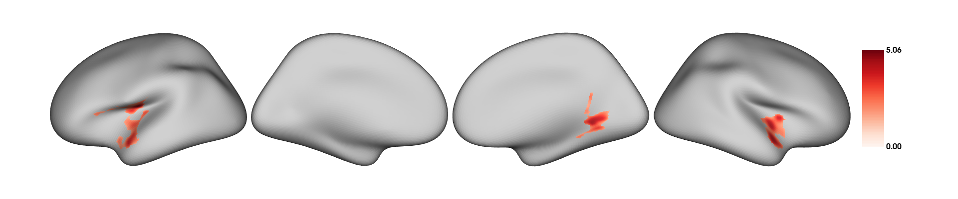

results=RFT_vertex_analysis(model = all_pred, contrast =all_pred$sex, surf_data = dat_CT)
results$cluster_level_results## The binary variable 'sex' will be recoded with F=0 and M=1 for the analysis
## smooth_FWHM argument was not given. surf_data will not be smoothed here.
## 1 1 301 <0.001 -40.7 -13.0 16.5 5.06 lh-postcentral
## 2 2 181 0.002 56.3 12.1 -10.1 4.43 rh-superiortemporal
## 3 3 150 0.003 21.9 -51.6 -1.2 4.41 rh-lingual
## [1] "No significant clusters"
plot_surf(surf_data = results$thresholded_tstat_map,filename = "sexdiff.png")
According to these results, since the female sex is coded as 0 and males as 1 (this can be done manually beforehand), the regions colored in red are thicker in males.
Now, let’s enter the thresholded_tstat_map into the
decode_img() function. The previous results only contained
positive clusters. But in case of bidirectionality, the function
requires to choose one direction with the contrast option. In this
instance, we simply decode the positive clusters, by setting
contrast="positive".

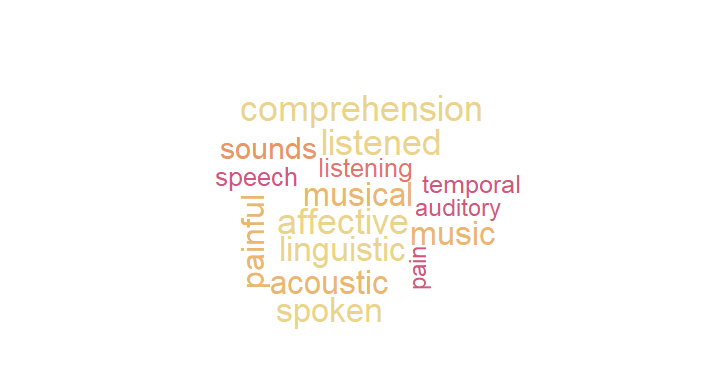

keywords=decode_surf_data(surf_data=results$thresholded_tstat_map, contrast = "positive")##Converting and interpolating the surface data ...
## Correlating input image with images in the neurosynth database. This may take a while ...
print(keywords[1:10,])## keyword r
##449 pain 0.099
##50 auditory 0.098
##648 temporal 0.093
##617 speech 0.092
##334 listening 0.089
##607 sounds 0.070
##450 painful 0.068
##4 acoustic 0.062
##397 music 0.062
##398 musical 0.062
The above procedure will display the top 10 keywords from images in
the database that are the most correlated with your input image.
According to these results, you can see that the positive clusters
(which are thicker in males) are typically found to be associated with
pain and auditory processing. If you simply run keyword
without specifying the index within the square brackets
[1:10,]. All 715 keywords will be displayed.
In your presentation slides or results section of your paper, you might want to illustrate these keywords using the wordcloud and paletteer packages. You can set the size of the keyword to vary according to its r value:
#install.packages("wordcloud","paletteer")
library(wordcloud)
library(paletteer)
wordcloud(words = keywords$keyword, ##keyword input
freq = keywords$r, ##setting the size of the keyword to vary with its r value
min.freq = 0.05, ##minimum r value in order for the keyword to be displayed
colors=paletteer_c("grDevices::Temps", 10) ##color scheme

These keywords may not be very accurate but they should give a rough idea for interpreting your results. Take note that these keywords are specific to the positive clusters.
