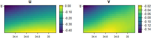

Currents information about the flow directions is usually split into
horizontal (\(u\)) and vertical (\(v\)) components, regarding the horizontal
and the vertical flow of the currents, respectively. As an example we
use a modified yearly aggregated subset of the Black Sea site (Lima et
al., 2020; Schulzweida, 2023) provided in the form of
SpatRaster elements. This input can be plotted using the
following:
# Import packages
library(SeaGraphs)
library(terra)
# Get example u and v components
component_u <- get_component_u()
component_v <- get_component_v()
# Plot each component
par(mfrow=c(1,2), las=1)
plot(component_u, main="u")
plot(component_v, main="v")
Figure 1: Currents \(u\) and \(v\) components.
In Figure 1 the two directions of
components \(u\) and \(v\) are presented, with higher currents
values detected at the South-West direction. A directed spatial graph in

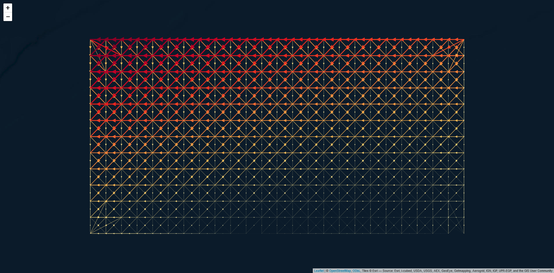

component_v = component_v)Flow and antpath leaflet maps are two possible graphical
representations of such graphs using the SeaGraphs could be
performed, but using graph_result elements, like the
shapefile one is possible as well. Note that the South-Western
directions of flows and magnitudes the final graphs are depicted in both
Figures 2 and 3.
Note that these outputs are dependent on the selected number of nearest
neighbors in the seagraph function.
flows_sfn(graph_result)

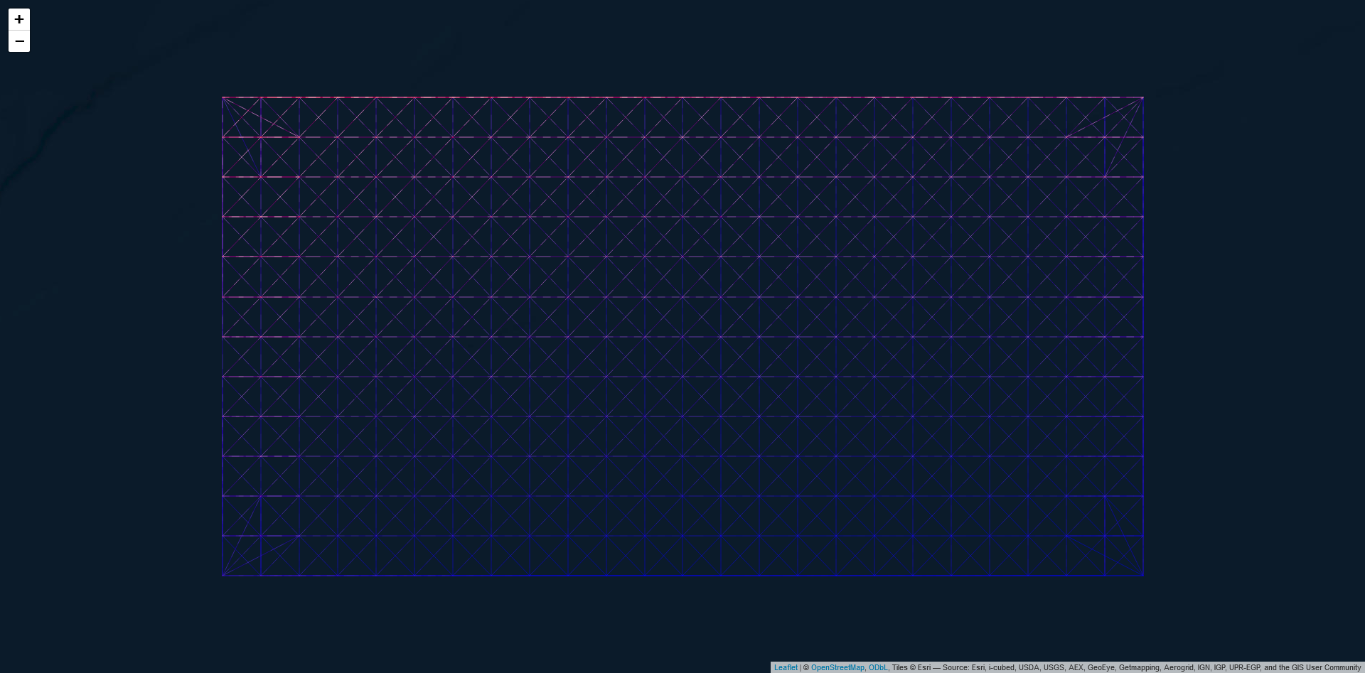

antpath_sfn(graph_result)
Figure 3: Antpath leaflet map.
