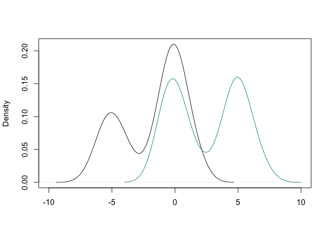

set.seed(123)
y <- c(rnorm(50,-5,1), rnorm(170,0,1),rnorm(70,5,1))
g <- c(rep(1,150), rep(2, 140))
plot(density(y[g==1]), xlim = c(-10,10), main = "", xlab = "")
lines(density(y[g==2]), col = "cyan4")

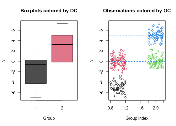

#> Elapsed time: 1.625 secsclusters <- estimate_clusters(out)
clusters
#> Summary of the estimated observational and distributional clusters
#> Estimated number of observational clusters: 4
#> Estimated number of distributional clusters: 2
#> Distributional cluster 1
#> post_mean post_var
#> 1 -4.96559645 0.8572352
#> 2 -0.05374608 0.9306906
#> Distributional cluster 2
#> 3 -0.00160923 0.7737203
#> 4 5.03452815 0.8314760plot(out, estimated_clusters = clusters)
