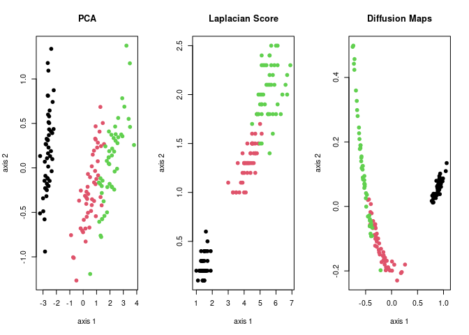

devtools::install_github("kisungyou/Rdimtools")Here is an example of dimension reduction on the famous
iris dataset. Principal Component Analysis
(do.pca), Laplacian Score (do.lscore), and
Diffusion Maps (do.dm) are compared, each from a family of
algorithms for linear reduction, feature extraction, and nonlinear
reduction.
# load the library
library(Rdimtools)
# load the data
X = as.matrix(iris[,1:4])
lab = as.factor(iris[,5])
# run 3 algorithms mentioned above
mypca = do.pca(X, ndim=2)
mylap = do.lscore(X, ndim=2)
mydfm = do.dm(X, ndim=2, bandwidth=10)
# visualize
par(mfrow=c(1,3))
plot(mypca$Y, pch=19, col=lab, xlab="axis 1", ylab="axis 2", main="PCA")
plot(mylap$Y, pch=19, col=lab, xlab="axis 1", ylab="axis 2", main="Laplacian Score")
plot(mydfm$Y, pch=19, col=lab, xlab="axis 1", ylab="axis 2", main="Diffusion Maps")

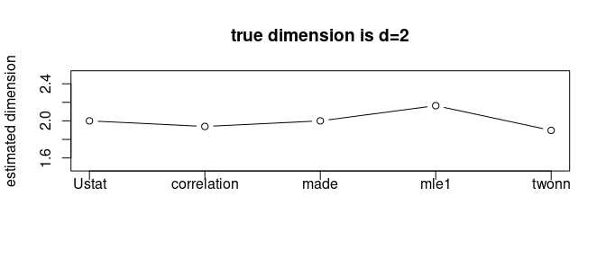

Swill Roll is a classic example of 2-dimensional manifold embedded in
\(\mathbb{R}^3\) and one of 11 famous
model-based samples from aux.gensamples() function. Given
the ground truth that \(d=2\), let’s
apply several methods for intrinsic dimension estimation.
# generate sample data
set.seed(100)
roll = aux.gensamples(dname="swiss")
# we will compare 6 methods (out of 17 methods from version 1.0.0)
vecd = rep(0,5)
vecd[1] = est.Ustat(roll)$estdim # convergence rate of U-statistic on manifold
vecd[2] = est.correlation(roll)$estdim # correlation dimension
vecd[3] = est.made(roll)$estdim # manifold-adaptive dimension estimation
vecd[4] = est.mle1(roll)$estdim # MLE with Poisson process
vecd[5] = est.twonn(roll)$estdim # minimal neighborhood information
# let's visualize
plot(1:5, vecd, type="b", ylim=c(1.5,2.5),
main="true dimension is d=2",
xaxt="n",xlab="",ylab="estimated dimension")
xtick = seq(1,5,by=1)
axis(side=1, at=xtick, labels = FALSE)
text(x=xtick, par("usr")[3],
labels = c("Ustat","correlation","made","mle1","twonn"), pos=1, xpd = TRUE)
We can observe that all 5 methods we tested estimated the intrinsic dimension around \(d=2\). It should be noted that the estimated dimension may not be integer-valued due to characteristics of each method.
