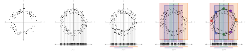

Step visualize from
Skaf et al.
Mapper is basically a three-step process:
1. Cover: This step splits the data into overlapping intervals and creates a cover for the data.
2. Cluster: This step clusters the data points in each interval the cover creates.
3. Simplicial Complex: This step combines the two steps above, which connects the data points in the cover to create a simplicial complex.
you can know more about the basic here: Chazal, F., & Michel, B. (2021). An introduction to topological data analysis: fundamental and practical aspects for data scientists. Frontiers in artificial intelligence, 4, 667963.

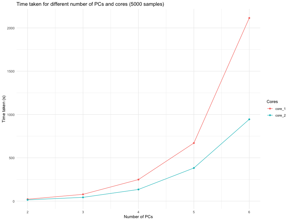

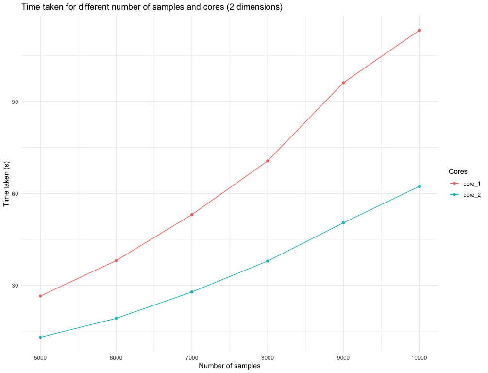

Main Goals 1. Computational
Optimization: The current version speeds up computations by 100
times compare to the original code, and could be faster by using
num_cores.

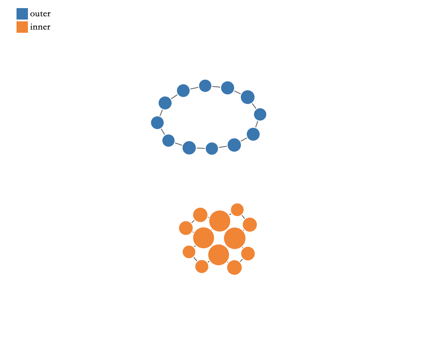

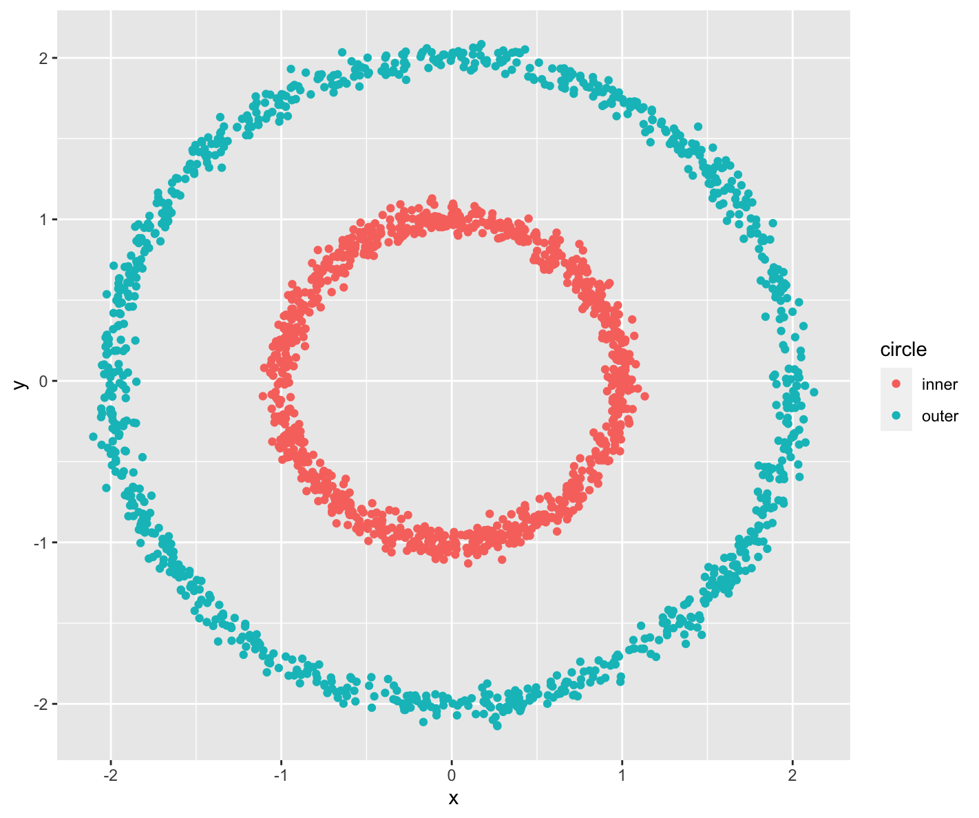

Mapper <- MapperAlgo(
filter_values = circle_data[,2:3],
intervals = 4,
percent_overlap = 30,
methods = "dbscan",
method_params = list(eps = 0.3, minPts = 5),
cover_type = 'extension',
num_cores = 12
MapperPlotter(Mapper, circle_data$circle, circle_data, type = "forceNetwork")
![]() Figure 1 |
