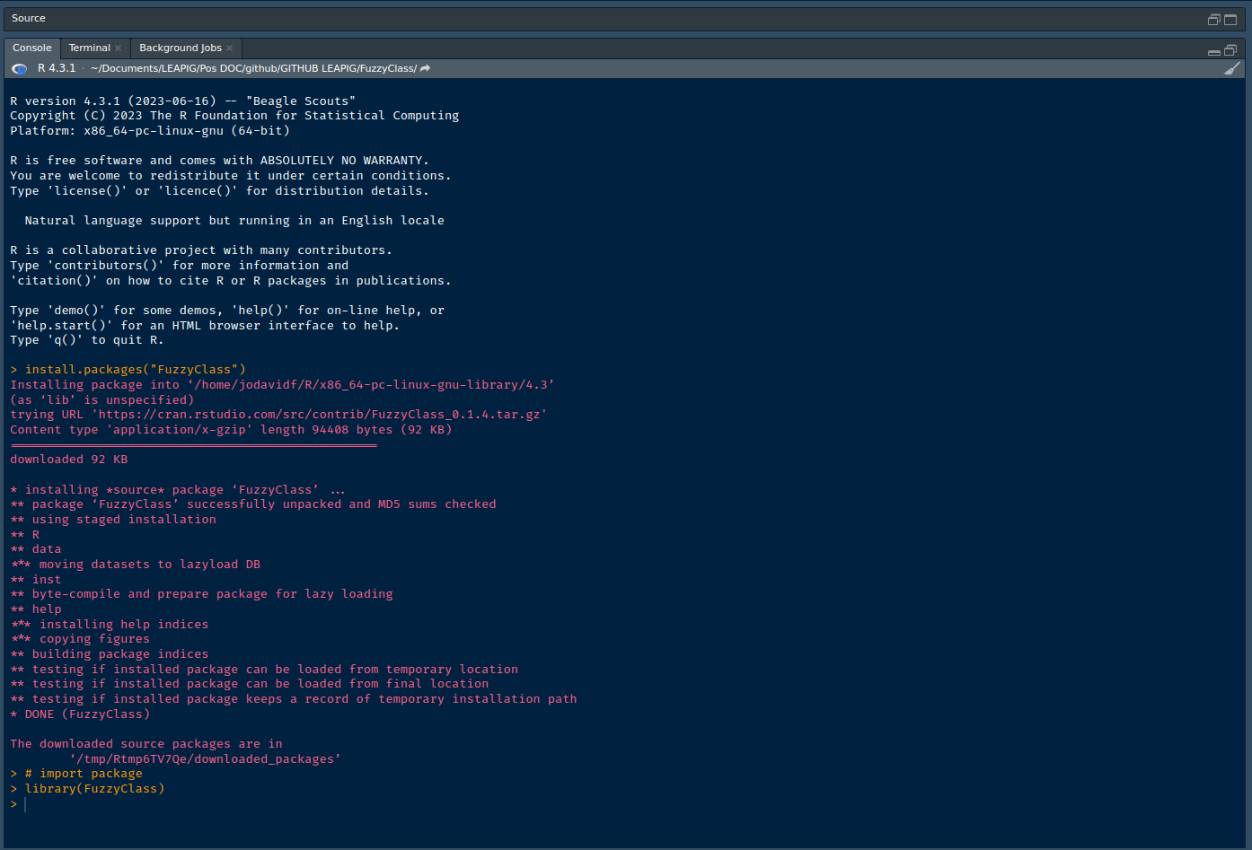

# Installation
install.packages("devtools")
devtools::install_github("leapigufpb/FuzzyClass")Once installed, you can load the FuzzyClass package into
your R session:
# Package import
library(FuzzyClass)
