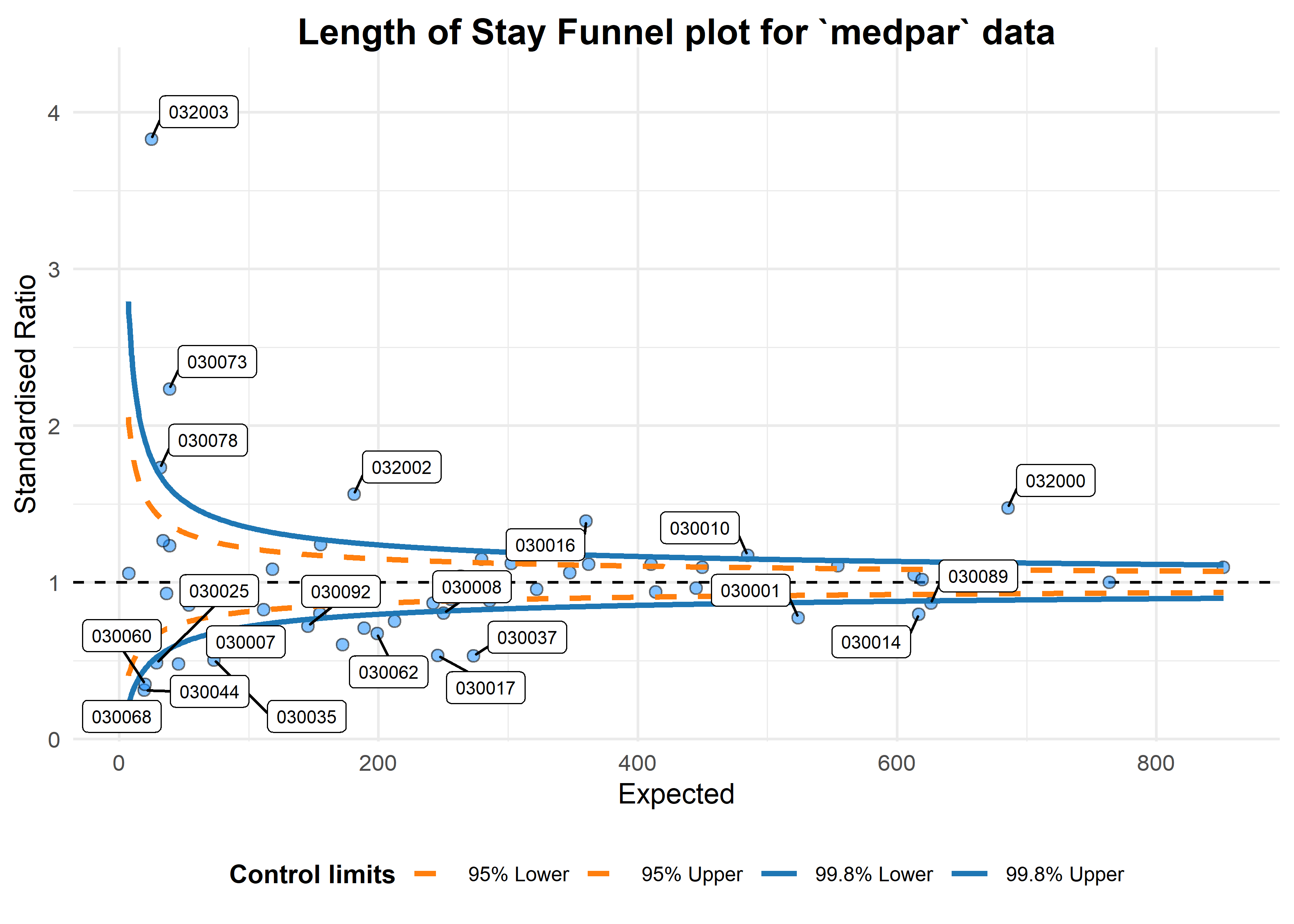

We can build a funnel plot object with standard Poisson
limits, and outliers labelled.
a<-funnel_plot(medpar, numerator=los, denominator=prds, group = provnum,
title = 'Length of Stay Funnel plot for `medpar` data', data_type="SR", limit=99,
draw_unadjusted = TRUE, draw_adjusted = FALSE, label="outlier")
print(a)
#> A funnel plot object with 54 points of which 25 are outliers.
#> Plot is not adjusted for overdispersion.
That looks like too many outliers! There is more variation in our
data than we would expect, and this is referred to as:
overdispersion. So lets check for it:

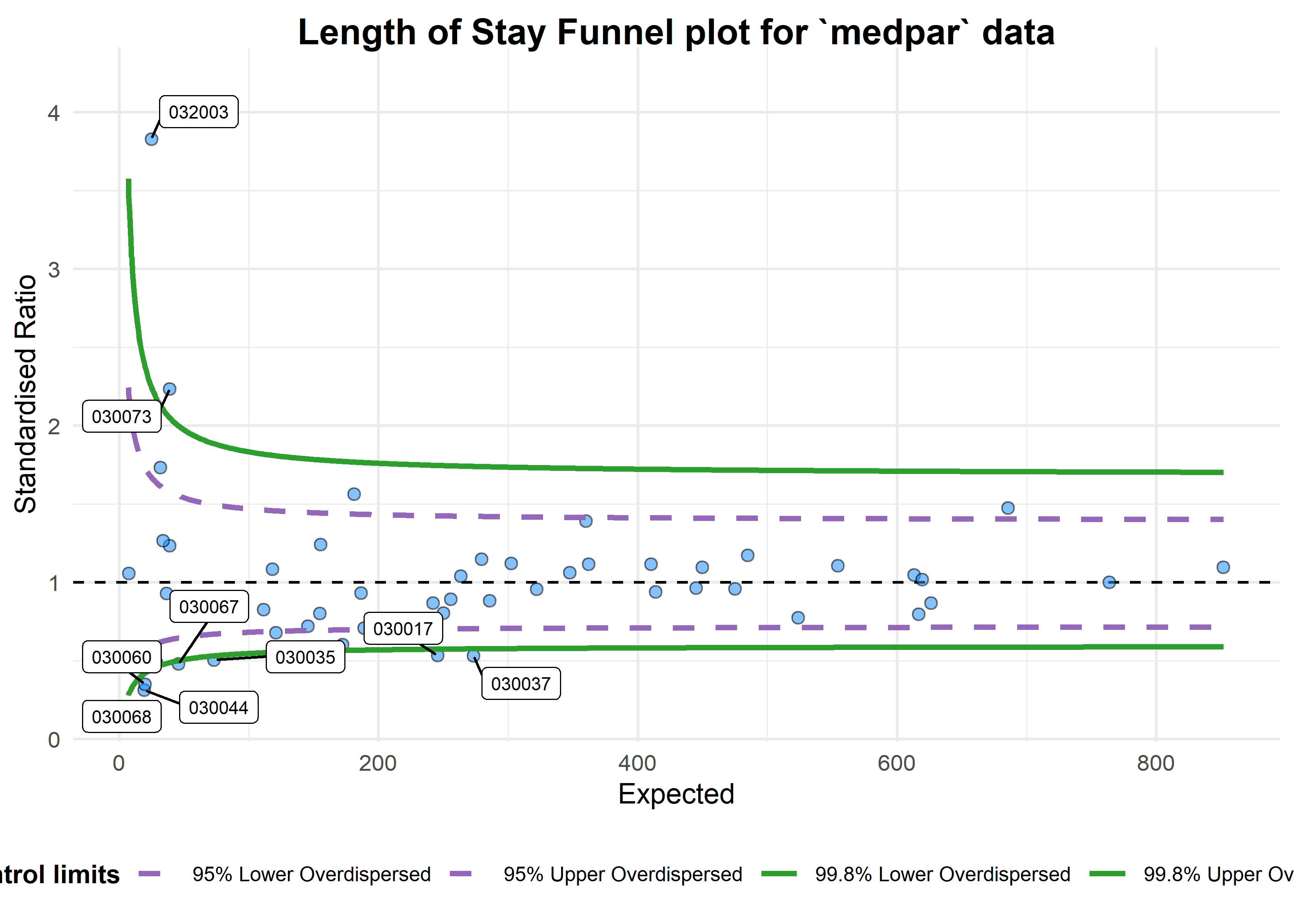

The
following ratio should be 1 if our data are conforming to Poisson
distribution assumption (conditional mean = variance). If it is greater
than 1, we have overdispersion:
sum(mod$weights * mod$residuals^2)/mod$df.residual
#> [1] 6.240519This suggest the variance is 6.24 times the condition mean, and definitely overdispersed. This is a huge topic, but applying overdispersed limits using either SHMI or Spiegelhalter methods adjust for this by inflating the limits:
b<-funnel_plot(medpar, numerator=los, denominator=prds, group = provnum, data_type = "SR",
title = 'Length of Stay Funnel plot for `medpar` data', draw_unadjusted = FALSE,
draw_adjusted = TRUE, sr_method = "SHMI", label="outlier", limit=99)
print(b)
#> A funnel plot object with 54 points of which 9 are outliers.
#> Plot is adjusted for overdispersion.
