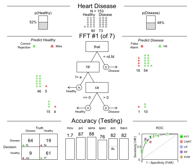

FFTrees object to visualize a tree and
its predictive performance (on the test data):# Plot the best tree applied to the test data:
plot(heart_fft,
data = "test",
main = "Heart Disease")
Figure 1: A fast-and-frugal tree (FFT) predicting
heart disease for test data and its performance
characteristics.
A summary of the trees in our FFTrees object and
their key performance statistics can be obtained by
summary(heart_fft).

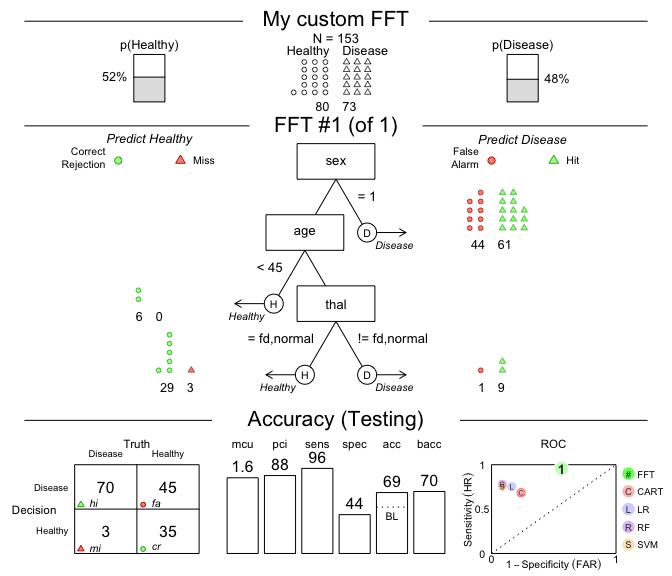

FFTs are so simple that we even can create them ‘from words’ and then
apply them to data.
For example, let’s create a tree with the following three nodes and
evaluate its performance on the heart.test data:
sex = 1, predict Disease.age < 45, predict Healthy.thal = {fd, normal}, predict Healthy,These conditions can directly be supplied to the my.tree
argument of FFTrees():
# Create custom FFT 'in words' and apply it to test data:
# 1. Create my own FFT (from verbal description):
my_fft <- FFTrees(formula = diagnosis ~.,
data = heart.train,
data.test = heart.test,
decision.labels = c("Healthy", "Disease"),
my.tree = "If sex = 1, predict Disease.
If age < 45, predict Healthy.
If thal = {fd, normal}, predict Healthy,
Otherwise, predict Disease.")
# 2. Plot and evaluate my custom FFT (for test data):
plot(my_fft,
data = "test",
main = "My custom FFT")
Figure 2: An FFT predicting heart disease created from a verbal description.
The performance measures (in the bottom panel of
Figure 2) show that this particular tree is somewhat
biased: It has nearly perfect sensitivity (i.e., is good at
identifying cases of Disease) but suffers from low
specificity (i.e., performs poorly in identifying
Healthy cases). Expressed in terms of its errors,
my_fft incurs few misses at the expense of many false
alarms. Although the accuracy of our custom tree still exceeds
the data’s baseline by a fair amount, the FFTs in heart_fft
(created above) strike a better balance.
