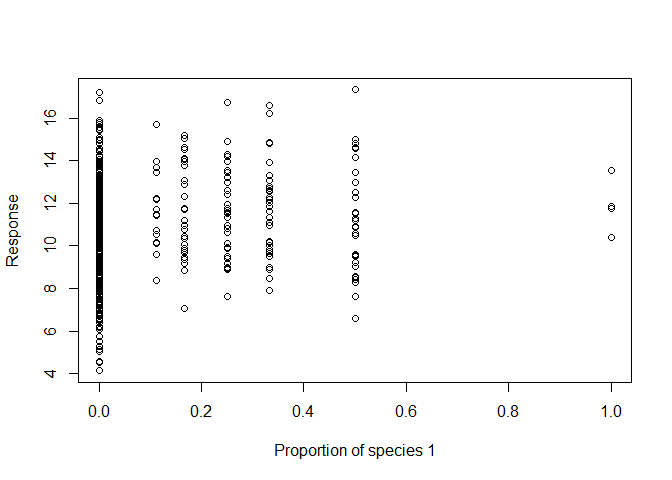

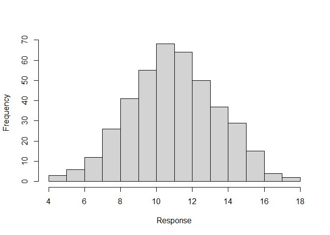

There are several graphical displays that will help to explore the data and it may also be useful to generate summary statistics.
hist(sim3$response, xlab = "Response", main = "")
# Similar graphs can also be generated for the other species proportions.
plot(sim3$p1, sim3$response, xlab = "Proportion of species 1", ylab = "Response")
summary(sim3$response)
#> Min. 1st Qu. Median Mean 3rd Qu. Max.
#> 4.134 9.327 10.961 10.994 12.604 17.323autoDIThe function autoDI in DImodels provides a
