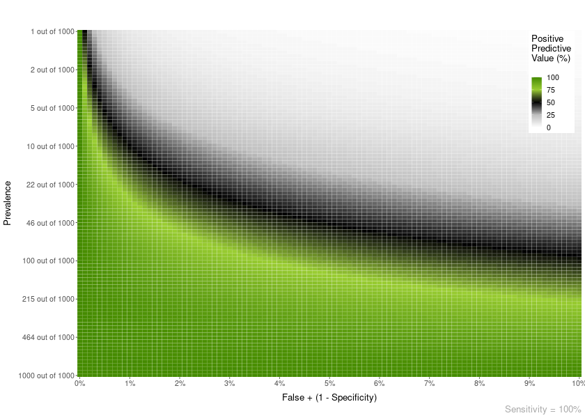

Plot heatmaps with PPV or NPV values for a given specificity and a range of Prevalences and FP or FN (1 - Sensitivity). The basic parameters are:
PPV_heatmap(min_Prevalence = 1,
max_Prevalence = 1000,
Sensitivity = 100, limits_Specificity = c(90, 100),
Language = "en")

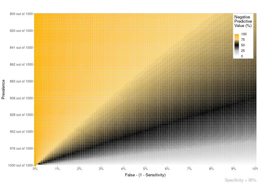

You can also plot an NPV heatmap with PPV_NPV = “NPV”.
PPV_heatmap(PPV_NPV = "NPV",
min_Prevalence = 800, max_Prevalence = 1000,
Specificity = 95, limits_Sensitivity = c(90, 100),
Language = "en")

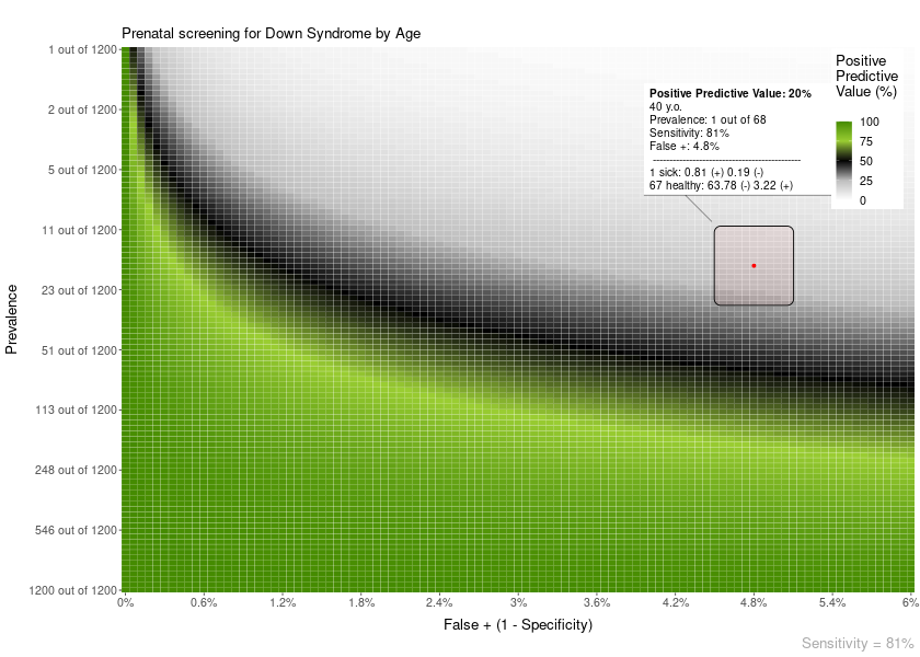

You can add different types of overlay to the plots.
For example, an area overlay showing the point PPV for a given prevalence and FP or FN:
PPV_heatmap(min_Prevalence = 1, max_Prevalence = 1200,
Sensitivity = 81,
limits_Specificity = c(94, 100),
label_subtitle = "Prenatal screening for Down Syndrome by Age",
overlay = "area",
overlay_labels = "40 y.o.",
overlay_position_FP = 4.8,
overlay_prevalence_1 = 1,
overlay_prevalence_2 = 68)
The area plot overlay can show more details about how the calculation of PPV/NPV is performed:
Sensitivity = 81,
overlay_extra_info = TRUE,
overlay = "area",

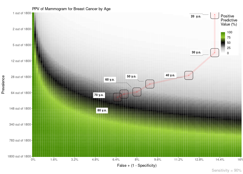

Also, you can add a line overlay highlighting a range of prevalences and FP. This is useful, for example, to show how the PPV of a test changes with age:
PPV_heatmap(min_Prevalence = 1, max_Prevalence = 1800,
Sensitivity = 90,
limits_Specificity = c(84, 100),
label_subtitle = "PPV of Mammogram for Breast Cancer by Age",
overlay = "line",
overlay_labels = c("80 y.o.", "70 y.o.", "60 y.o.", "50 y.o.", "40 y.o.", "30 y.o.", "20 y.o."),
overlay_position_FP = c(6.5, 7, 8, 9, 12, 14, 14),
overlay_prevalence_1 = c(1, 1, 1, 1, 1, 1, 1),
overlay_prevalence_2 = c(22, 26, 29, 44, 69, 227, 1667))

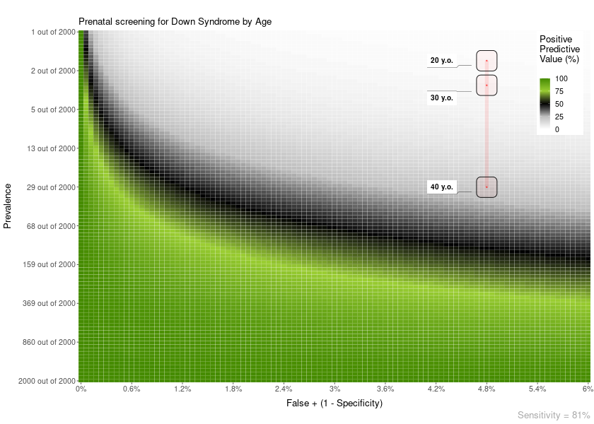

Another example. In this case, the FP is constant across age:
PPV_heatmap(min_Prevalence = 1, max_Prevalence = 2000, Sensitivity = 81,
overlay = "line",
overlay_labels = c("40 y.o.", "30 y.o.", "20 y.o."),
overlay_position_FP = c(4.8, 4.8, 4.8),
overlay_prevalence_1 = c(1, 1, 1),
overlay_prevalence_2 = c(68, 626, 1068))

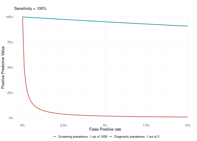

In scientific studies developing a new test for the early detection of a medical condition, it is quite common to use a sample where 50% of participants has a medical condition and the other 50% are normal controls. This has the unintended effect of maximizing the PPV of the test.
This function shows a plot with the difference between the PPV of a diagnostic context (very high prevalence; or a common study sample, e.g. ~50% prevalence) versus that of a screening context (lower prevalence).
PPV_diagnostic_vs_screening(max_FP = 10,
Sensitivity = 100,
prevalence_screening_group = 1000,
prevalence_diagnostic_group = 2)

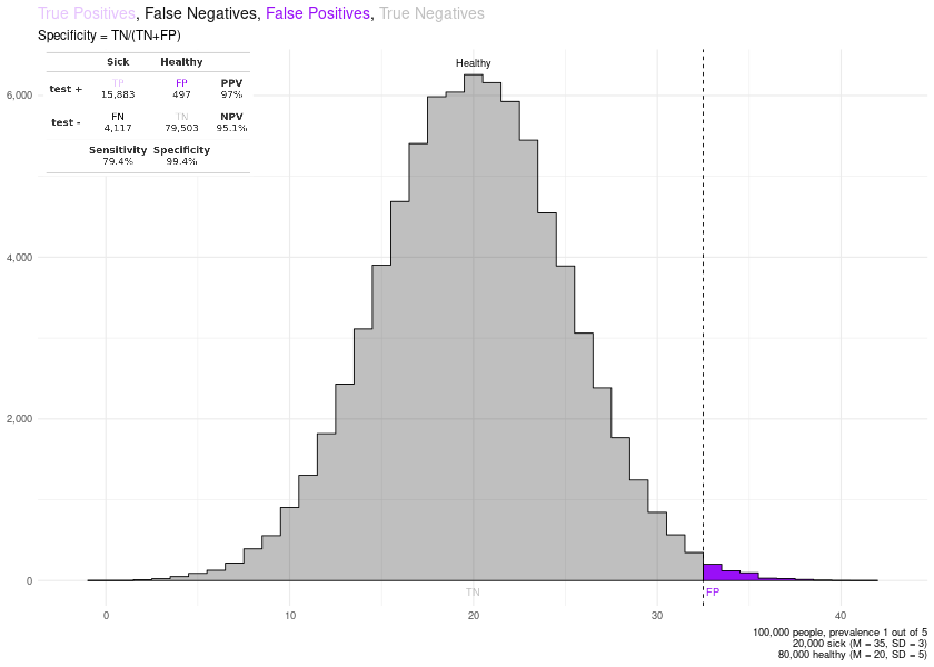

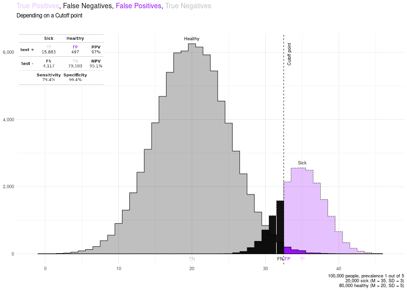

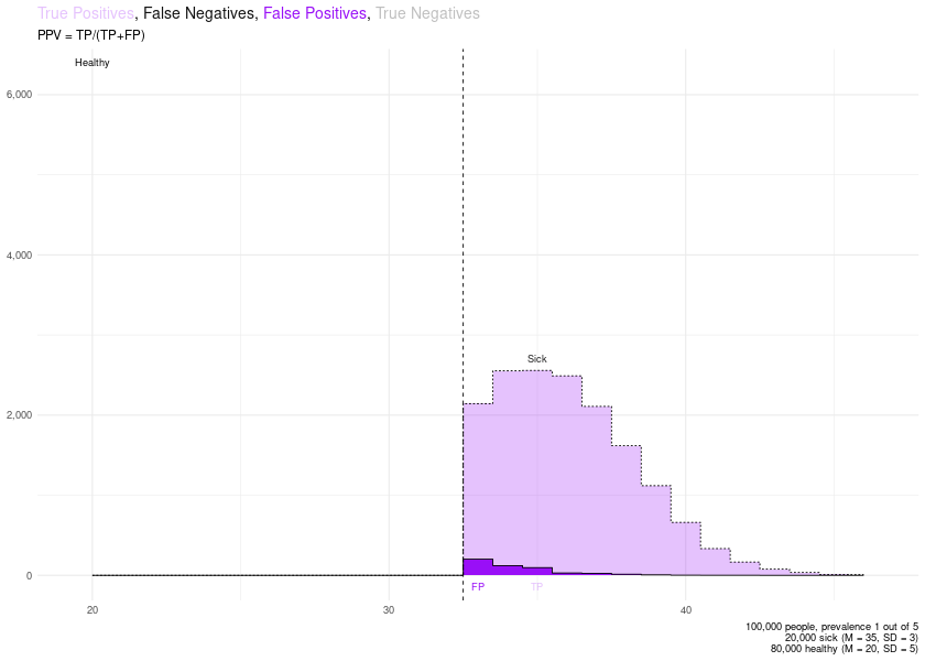

Since v0.4.2 you can also plot the distributions of sick and healthy individuals and learn about how a cutoff point changes the True Positives, False Positives, True Negatives, False Negatives, Sensitivity, Specificity, PPV and NPV.
PLOTS = plot_cutoff(prevalence = 0.2,
cutoff_point = 33,
mean_sick = 35,
mean_healthy = 20,
sd_sick = 3,
sd_healthy = 5
PLOTS$final_plot
Then, with remove_layers_cutoff_plot() you can remove
specific layers, to help you understand some of these concepts.

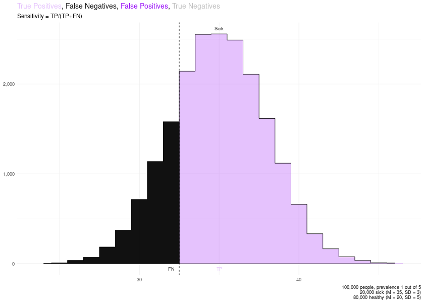

# Sensitivity
remove_layers_cutoff_plot(PLOTS$final_plot, delete_what = c("FP", "TN")) + ggplot2::labs(subtitle = "Sensitivity = TP/(TP+FN)")
# Specificity
remove_layers_cutoff_plot(PLOTS$final_plot, delete_what = c("FN", "TP")) + ggplot2::labs(subtitle = "Specificity = TN/(TN+FP)")

remove_layers_cutoff_plot(PLOTS$final_plot, delete_what = c("TN", "FN")) + ggplot2::labs(subtitle = "PPV = TP/(TP+FP)")

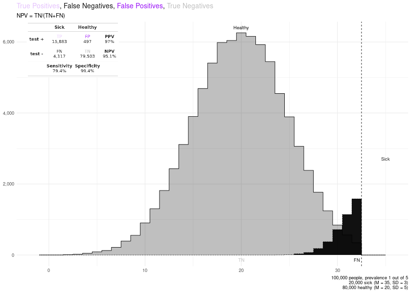

# NPV
remove_layers_cutoff_plot(PLOTS$final_plot, delete_what = c("TP", "FP")) + ggplot2::labs(subtitle = "NPV = TN/(TN+FN)")
